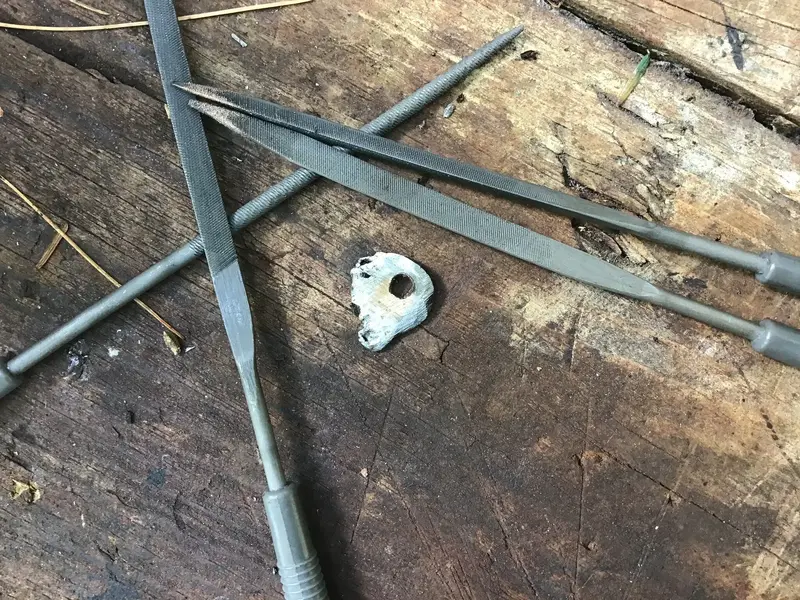

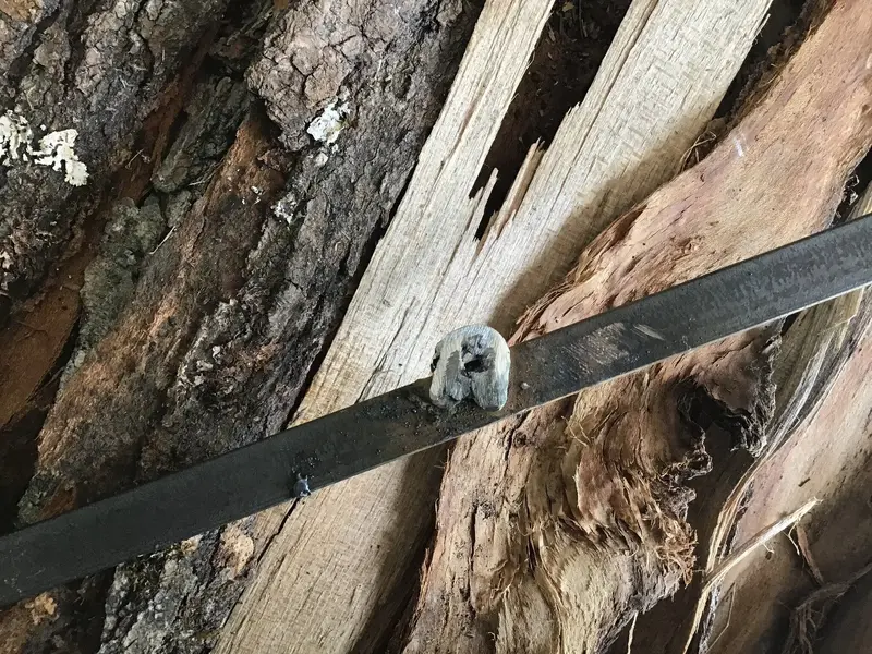

I haven’t given up on that pesky pedal. I took a heavy washer and tacked the side of it to some flat stock.
I filled the washer hole with brazing, banged the tack off the flat stock, drilled a small hole through the brazing, which is softer than weld hardened steel and started using tiny files to make a flat spot. This is going to be long term as I already have an hour of labor into it without much to show. You can only move the files about 1 mm. If I can get this homemade pedal D lock washer to fit I’ll have to grind down the washer diameter and thickness. In the meantime I’ll use the nos pedals.
