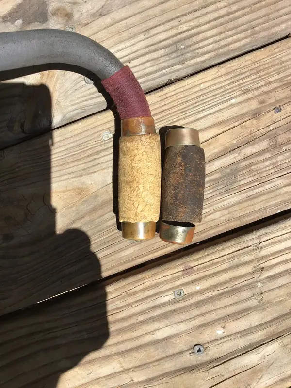

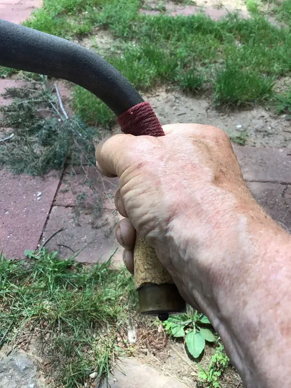

The grips and pedals are kid sized. My son is 6’1” and his feet are too big for the pedals. I’m 5’7” and I can use the pedals. The grips are also not long enough and smaller in diameter than modern grips. I used cut down and ground down rubberized cork replacements so the brass caps would slide over the cork, like original. I made the grip marginally longer than original and it’s still too short. If you make the cork longer than I did the curvature of the bars makes the brass fore cap crooked, which looks dumb. This is as long as you can go without that problem. I did a fishing rod builders fuerell wrap with cotton string to extend the gripping area. You really can’t reduce the diameter of the rubberized cork to fit the brass fittings more flush. It’s like trying to sand or file a tire. An angle grinder takes off chunks fast but you don’t have enough control. The grinder did reduce the diameter so the brass fitting slid over the cork.
Original grip length. 96A921E3-805F-4EB5-90FE-A7F4B772A3D8.jpeg D489591D-6070-4457-9855-DD42C14AA831.jpeg
I was able to save and reuse one of the original wood dowls that the end cap screws into. The other one fell out in pieces once the screw was removed. Done is better than perfect. A2588608-6B2C-4075-BE8F-198475059B91.jpeg
