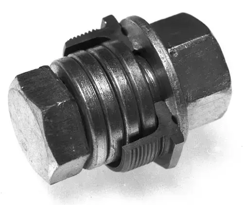

Fixed cup removal (with pics)
Am I right that this relies on the friction between the tool and the cup?

@Splatter Paint Am I right that this relies on the friction between the tool and the cup? Yes, exactly right. The cup is clamped solidly between the steel tube inside the BB shell and the penny washers outside. The cup is heat-treated steel, so much stronger than the washers and "will not" get damaged. Could you also use a headset spanner on the cup at the same time? I don't think there is actually any need. That cup was absolutely immovable with a headset spanner alone, but the huge force you can apply with a breaker bar means no spanner required.

Never seen this idea before, so thanks
A record vice across the flats and turning the frame has never failed me so far, but there is a risk it could slip
🤔 That's a new one to me and thanks for sharing. I'm pretty amazed it works with just a friction grab.
May give this a go in the future to a fixed cup that I've been reluctant (dare) to try without the proper tool which is impossible to find, and know the normal vice trick would end in tears. I imagine for this to work well parts need to be spotless, grease free and surfaces very flat.

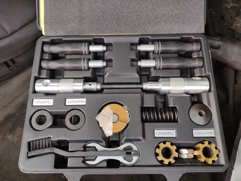

This is what I use if it’s proper stuck.
Step 1. Brute force
Step 2. Ignorance.
