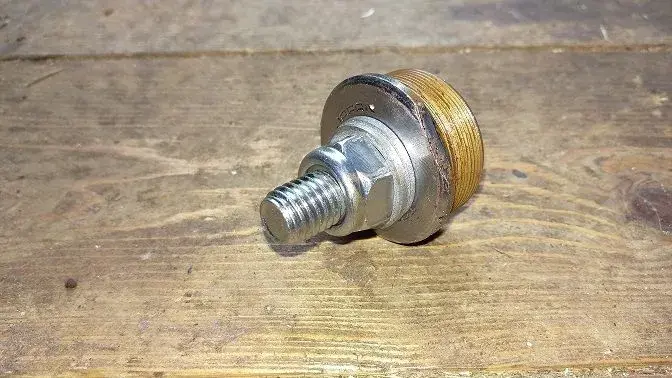

Re: JOB DONE
Bottom Bracket now removed

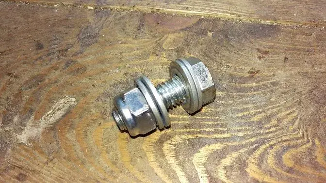

I left it soaking over night in WD40 (stuffed tissue in frame and laid frame down with tissue under bottom bracket then dowsed all tissue in wd40 so that it was constantly covered in wd40 ). Got a m12 bolt with washers through bracket and tightened nut on other side as tight as I possibly could, then removed socket from one side and simply turned it with a spanner. As it was so tight it was as one so by simply turning the nut with a spanner it all turned and released the Bottom Bracket. Job done :D
I have included pics to make it easier to understand

Well done. I have always used that method. 100% success rate. Nothing slips, no injuries and if the internal washer is not too big, you get zero damage to the cup. I use an M14 with no washer on the outside, which grips better.
