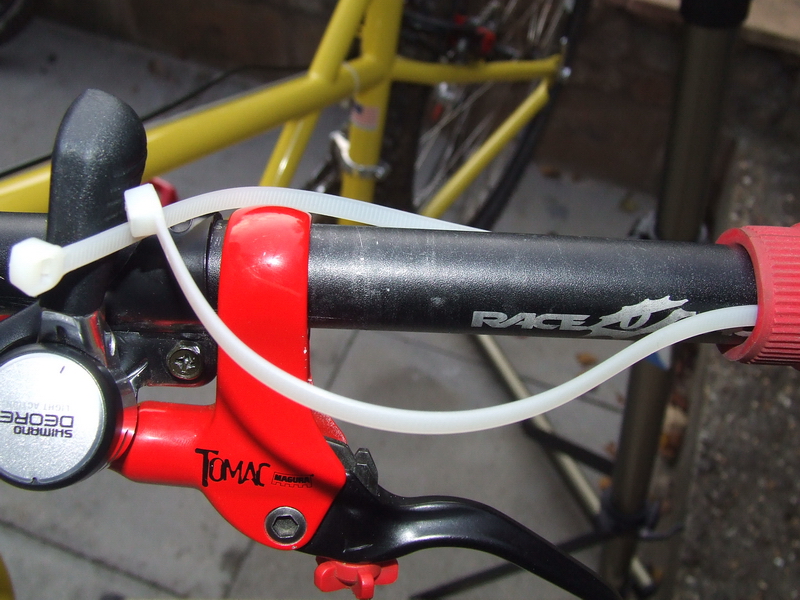

Blatantly copied and pasted from Neillls blog:
So, you've read about using GT-85 and WD-40, Hairspray, water, glue......what about the 'Zip Tie Trick'? Well, it works a treat. Get two long and strong Zip Ties, feed them down inside the grip, one either side, so the 'teeth' side faces the grip....push to get it started, make sure any logos or patterns are lined up how you want them, then 'ski' them up using the ties by pulling the ends (for best results ziptie the ties together so you have a 'handle'). Once they are all the way up, pull harder and the Zip Ties will slide out.
clockworkgazz":vq2hrp23 said:
getting them on- is there really a way to keep them on esp in the wet :evil:
the way I stated above, is for keeping them on, especially in the wet. I should have a pic somewhere. The zip ties won't crimp your bars, but will keep the grips from sliding off.
