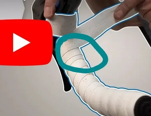

I don't do this job often but each time I'm about to do it I go back to review the Park tools video:
He shows the 'wrong' way to wrap at the STI levers and then the right way at the end. It's also slow and quite long, which forces me take my time.

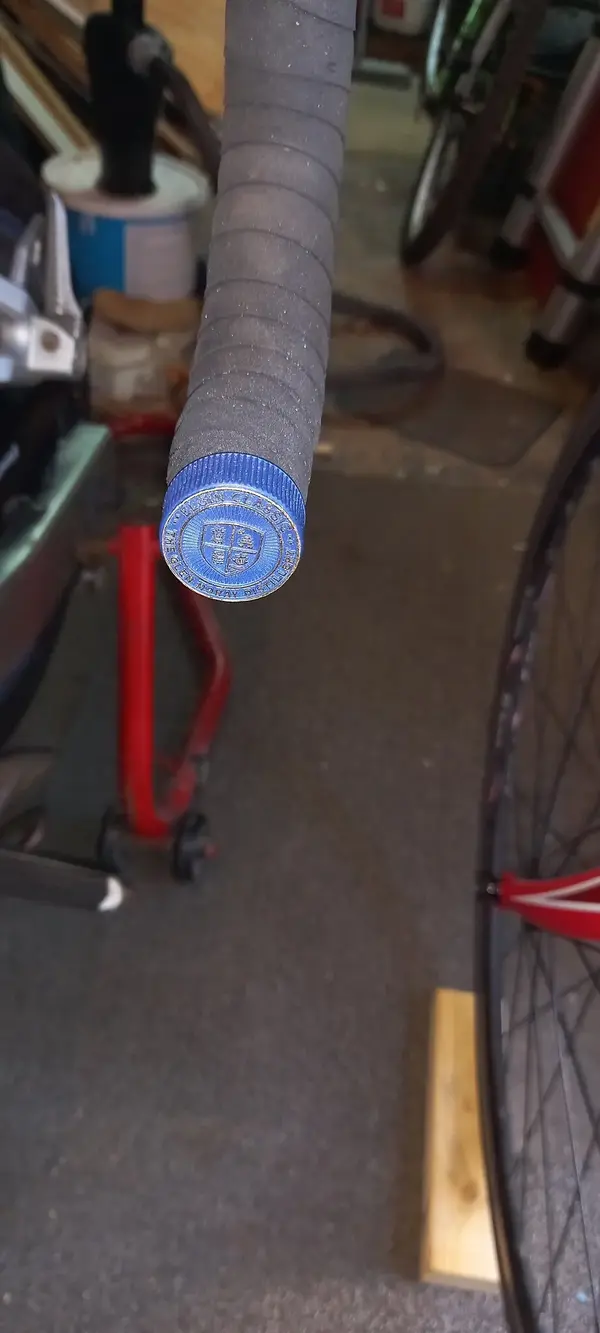

Personally I hate this job but my latest efforts have been ok:

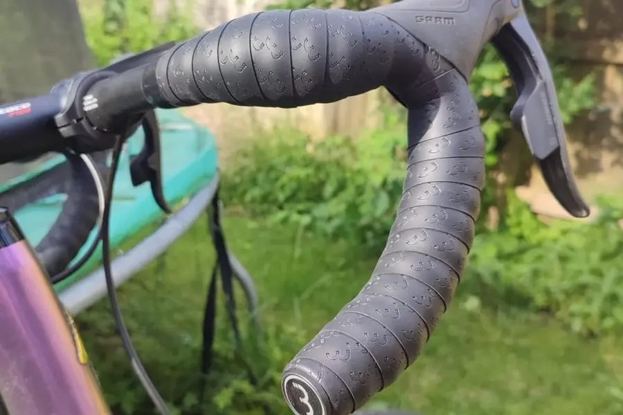

much as I don't like Park Tools, he does a very tidy job there, with none other than Cinelli tape too. :)
on the G&T Gravel 🤢 bike I have 1 strip of bar tape laid along the top of the back at the bend and on to the hood for the same purpose. no point in thickening the back up by double wrapping for me.

And in the park video... 20240715_083322.webp If we did that, I'd get it done again. 🤣
Maybe he sorts it out in the video, but I can't watch that stuff it makes me nauseous for some reason.
