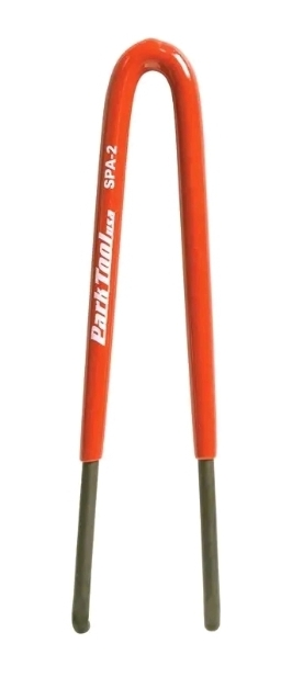

Don't answer the phone once you've started - although if you have a clean pin spanner... Screenshot_20240714-140133_eBay.jpg You can clip it over where you've wrapped to and answer the door, phone, spouse, call of nature etc without ruining it.

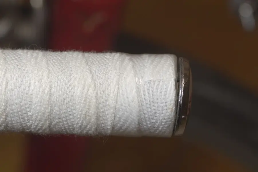

I still like cloth tape for looks and feel on my old bikes (pre-mid 80s), but I also like a bit of cushion so I have done this a couple times which worked well both in looks, comfort, and durability. I put 2 very thin lines of contact cement/glue on the bar with a bit wider swath on the outside of all bends (do not cover the entire bar, it's a mess and makes it hard if you need to reposition the tape). I then take cheap foam cushion tape (it is horrible if used by itself), color will not matter as it will not be seen, and do a non-overlapping wrap with it first while keeping the edges tight to each other and giving the bar a smooth appearance. I start about an inch from the bottom of the bar and stop about an inch from where I would normally wrap the bar near the stem. Next I do a normal wrap of cloth tape over the foam. I have generally always had enough to complete the bar, but a couple times either due to getting some shorter (?) rolls of tape, doing too much overlap, and/or wrapping a very wide bar I was slightly short when reaching the stem (probably the last 2 instances) so I had to use a little more electrical/finishing tape to complete the job. I practiced doing this first without any glue and also with more glue than I presently use. Some cloth tape either has no adhesive backing or it is very minimal. In that case I have used a couple thin lines of glue on the foam tape before wrapping the cloth over the top again using a little more around outer bends. I think using glue on each layer is best regardless.

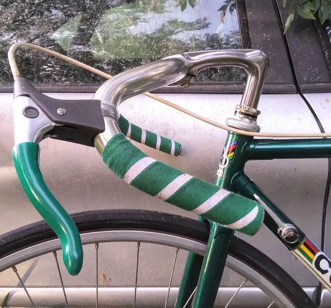

I need to do my bar on a bike I just rode with tape coming off/sliding around which I originally did in a similar manner except bottom layer was all cloth (no real cushion effect, done for looks only) with no overlap, and top cloth was wrapped in and "open" helix providing a 2 tone spiral effect having the bottom color partially exposed. I did it because I got a bar on a purchased bikr done in that manner and it looked cool. My work looked good for quite awhile, but it was an experiment and I never practiced with it prior. Mistake turned out to be not using any glue on the underside of the top cloth wrap which is what slid around (after a couple years; I wrapped it super tight) due to not having the best purchase with a cloth on cloth wrap. It never "curled up" at the edges though. It only slide down making it look all one color. Yesterday I had a streamer of tape while riding because I had not redone the job yet. No excuses! A possible solution would have been a urethane overspray to help secure the wrap; also keeps it cleaner. I will not use any white this next time!
Here is what it looked like when purchased before I got my grubby gloves on it. I redid it the the same way when it got dirty. This original wrap did not slip and the top did not peel off like my job did even with e-tape wrapping on the end (not sure if it was the type of tape or if previous owner added more adhesive).
My next effort will be a three color braid with cloth (cutting tape to 1/2 width). Never tried it so practicing with some old scrap.

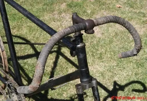

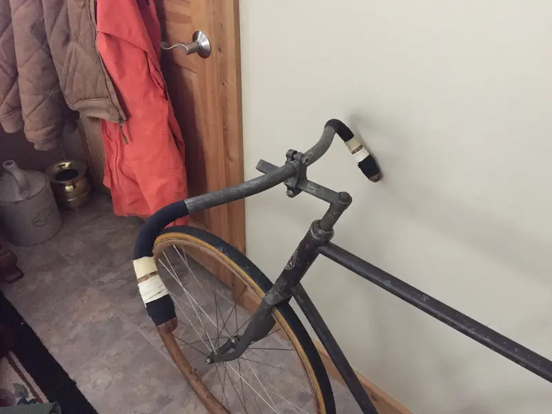

In the 60s-70s bar tape started at the stem and the tape end was stuffed into the bar end. That was held in place with the plugs. All the books showed this technique. I don’t know when thinking changed. Part of the problem is fragile tape nowadays. If you stretch it a little it breaks. There is no turgor to keep it firmly in place. I think it’s kinda dumb to start at the ends and use tape to hold the final wraps at the stem. Being old, I remember when stuff actually worked and lasted. I saw the world befor technology turned everything to shite. Anyway, I still wrap like I did in the 1960s. I don’t have any problems with it coming apart. I refuse to accept this new fangled idea. I’d use thin double sticky back tape around the brake levers before I reduce myself to this stupid backwards way of taping a bar. I just removed my soapbox from Hyde Park.
