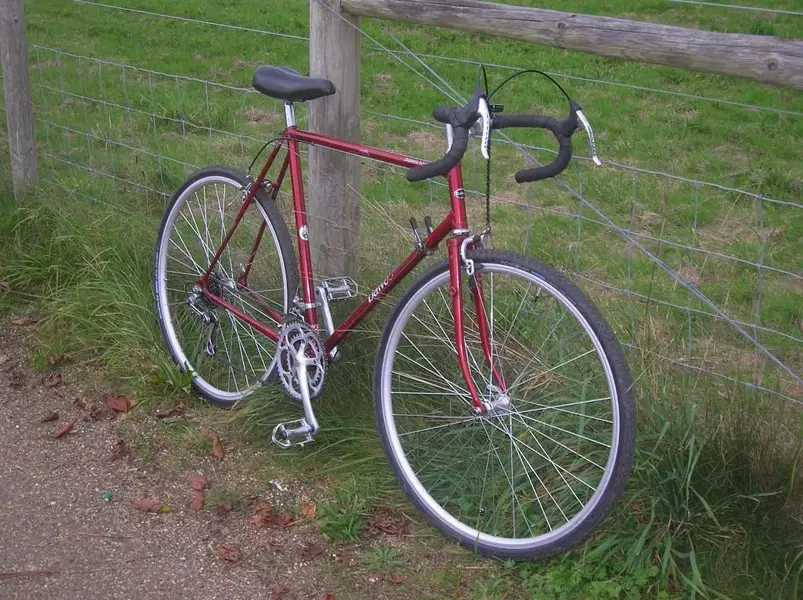

Well, this may make you wince - I squeezed a set of 135mm hybrid wheels into this scruffy Dawes Fox which was 120mm originally. It's a plain steel frame and the rear is really springy and spread very easily. I wouldn't do it to a 531 or similar frame but the bike wasn't getting much use and I needed a winter/path/bridleway beater. Ginormous ally mudguards about to be fitted. The pic makes it look better than it is, there's quite a bit of rust.
