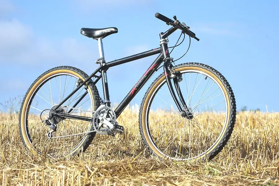

this summer bike. Bought as a frameset since a long time, that bike is riden again !
The paint job is not in good shape but I prefered to keep it with all its scuffs and… history.
Very stiff and inconfortable… but funny to ride
:D

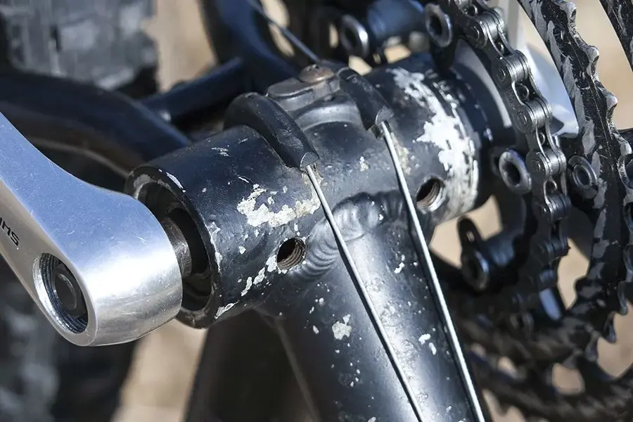

pressed BB Bearings and very thick aluminum tube set

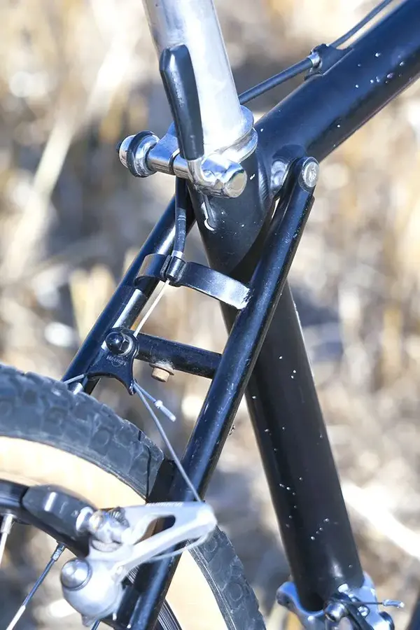

little bolt for sticking the rear Chromoly (Tange Prestige) triangle

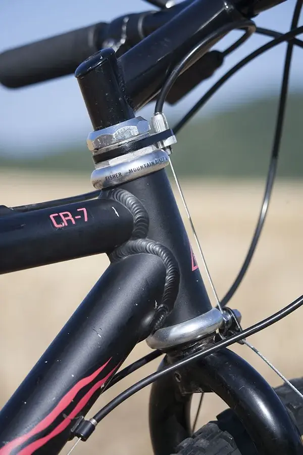

1"1/4 headset
Dia Compe brake lever and very narrow handlebar

What purpose do the two threaded holes in the bottom bracket shell serve?
Re: Re:
That's so you can get to the bolts that hold the rear end on!
That's what I would answer :D
The bike was designed by Richard Cunnigham with the same steel/aluminum bolt design as Mantis.
I was looking for that bike in small size since a long time. But the geometry is stange : very short (aroung 50cm top tube) and high (16" seat tube). I think that Gary Fisher with his quite 2m tall, never understood small sized bikers. My 16" RS1 is quite big for a small size.
