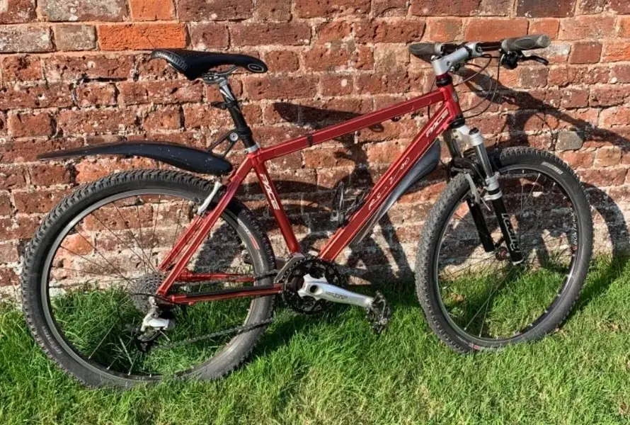

FINISHED! Another Pace RC200 Rescue Thread
So, ignoring the slight issue with the seatpost for the minute, this is now officially a bike again. Brakes need bedding in but I've even gone so far as to attach the flashing ball bag of glory to the saddle.
(will come back to the saddle issue in a couple of days, am bodging!)
So here she is, back from beyond after much effort from Dan, ready for Mayhem. As in, ready BEFORE Mayhem for a change.
Nice job!
Can you make a shim for the seat post? I’ve used drinks cans in the past or foil from take-away trays where the clearances are very small.
SP

Re: Re:
Splatter Paint":2ceyuwcp said:
Nice job!
SP
Thought about it, not tried it. As you say its a small difference in the diameter so could be a fiddle but I'll give it a go.
I have a black Syncros post that needs a bit of attention that fits fine, so I think I'll use that for now.

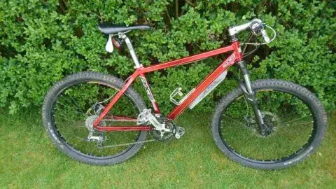

Rides well.
I'm short in the legs department so tend towards smaller frames. Length feels fine, not too short and a reasonable length stem so it doesn't feel too small.
I have a F8 19" frame waiting for building, then I can do a bit of back-to-back comparison and decide which I prefer.
