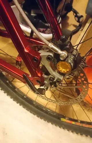

I have a selection of Hope mono mini and M4 brakes, but the funny caliper mount thing on the back of the frame is a tad too fat to fit the caliper to :evil: so I had to use a +20mm adapter. Currently wearing a Mono Mini caliper to fit a 180mm disc. (I have some other calipers that may fit but I went for this one as I know it works, this may get sorted if I ever get the spare calipers serviced)
Braided hose threaded through the frame guides so looks tidy enough, hose was just the right length too.

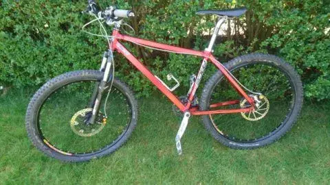

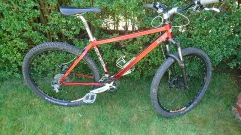

Holiday weekend morning while the kids are harassing the wife instead of me for a change, snook out for a quick fettle. Just the gears to cable up now

Putting some finishing touches on today and thought I was making good progress.
Then....
The seat post wibbles a bit. The clamp us tight but there's movement.
so I take the clamp off and let the new zoom lightweight post in, its not exactly a tight fit.
for comparison, the broken syncros post that came out is tight enough to slide in but you can pick the whole bike up with the friction into the frame.
both posts are clearly stamped 29.4.
Are syncros tending 'big'?
Is this just a slightly cack seatpost?
Grrr
