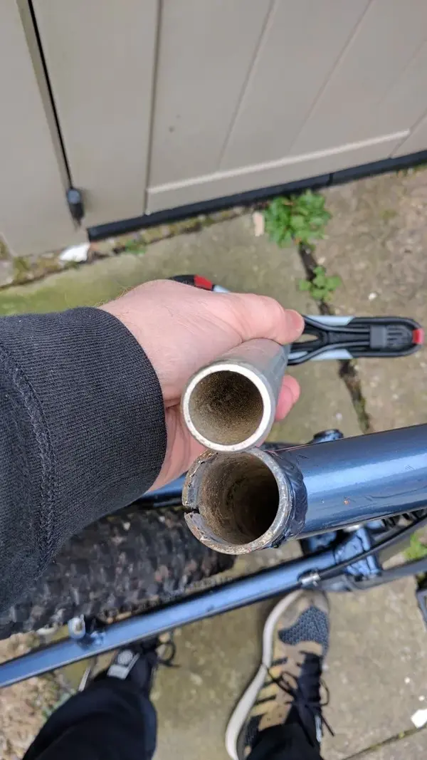

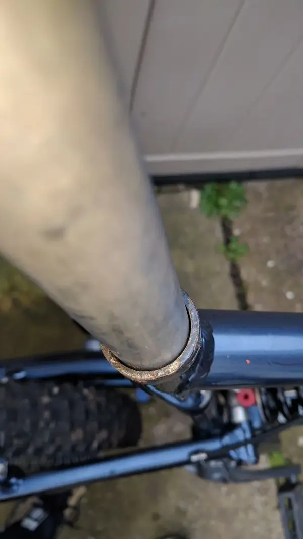

On a side note the seatpost is 26.0
Could a bigger one be put on or was this the spec. Seems a bit loose to me (it can tighten well though?
