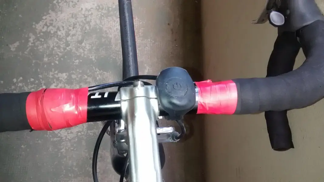

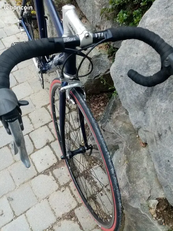

* the handlebar tape not installed correctly, leaving some bare metal at the end of it. One missing cap ;
* handlebar not aligned correctly (the bottom of it is not parallel to the top tube) ;

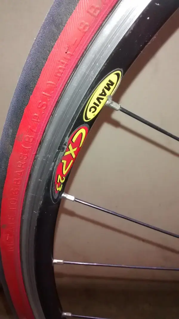

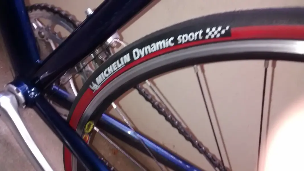

* tyres not at the right pression (3 bars instead of between 6 and 8 for these tyres) ;

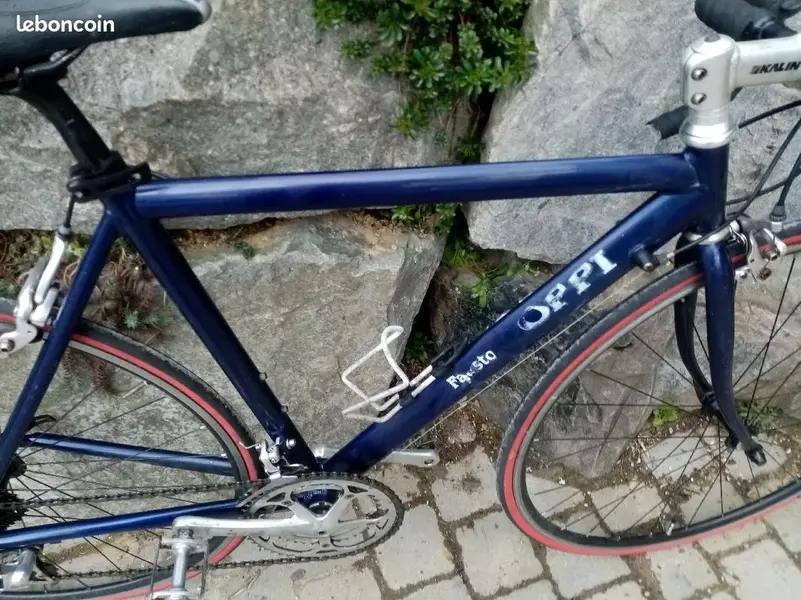

* the decals are also deteriorated ;

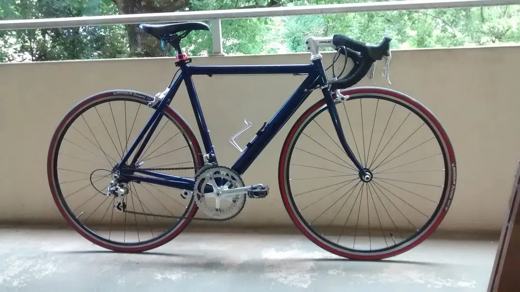

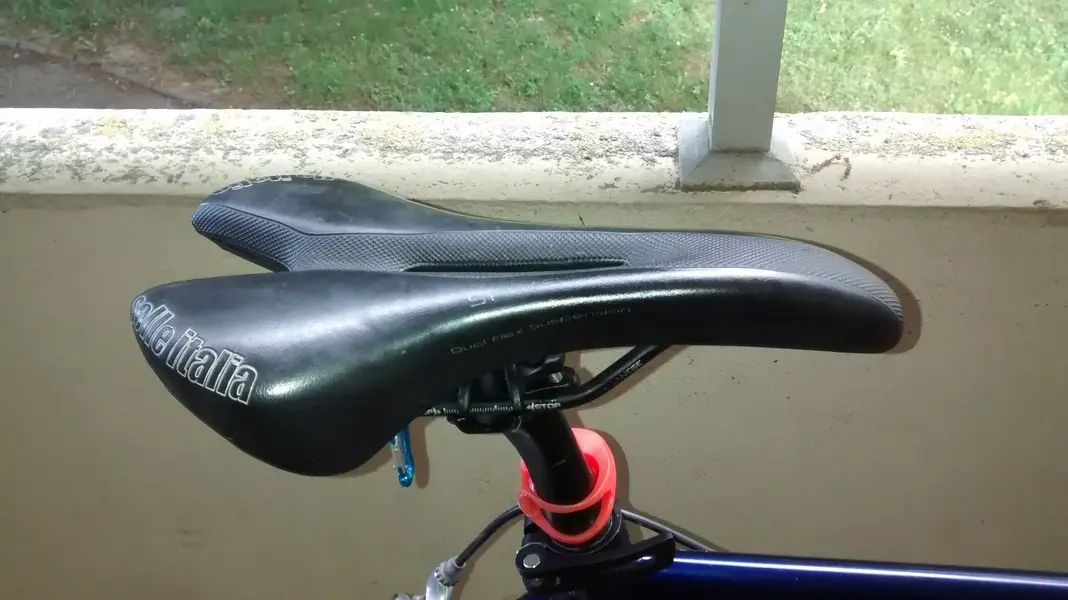

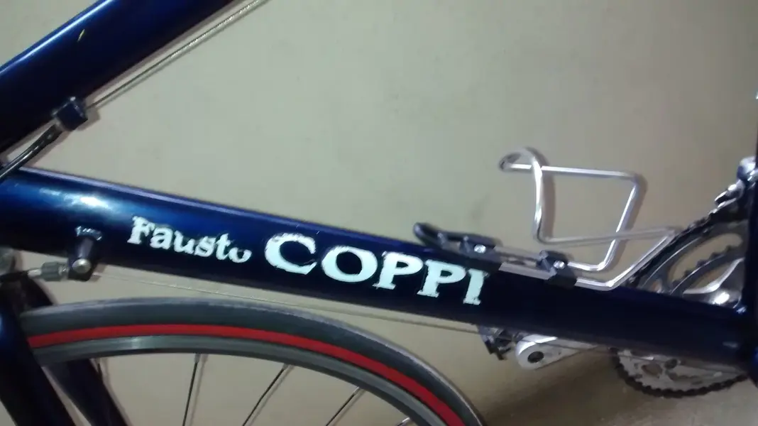

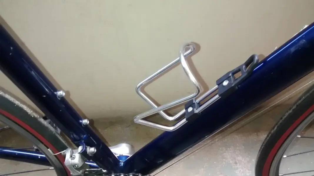

So, there is some work and I've already started. Good pression in the tyres, new (old but the two are identical) MTB resin pedals with no bearings problems (temporary, I'll buy aluminium ones on next tuesday). I pulled out and cleaned the two chainrings (and I tightened the screw after that). Just that make an enormous difference visually speaking ! I changed the saddle because I don't like to put my a** where another one took place (and with a dirty bike, brrrrrrr ! ). The new saddle is lighter (333 grams for the original one, 262 grams with mine, yeah ! ). I put little thingies at the end of the cables (bye tetanus !). I've verified the brake screws (OK), the stem screws (not OK, not even the littlest trace of grease, so, I put some grease and tightened them correctly). I aligned the handlebar correctly. I put some caps at the extremities of it (I haven't changed the handlebar tape yet). I got rid of the decals on one side of the bike (I don't want a Fausto OPPI but a Fausto COPPI with a C ! On the other side, it's better but it'll probably not be extra durable. I polished the frame (light polish) and I gave a good clean. I changed the screws of the bottle cage (and the bottle cage itself). Ah, and new quick releases (silver ones, even more beautiful than the black ones).
The bike is transformed, even if it's obviously not near to perfect. But I could ride with it with no fear.

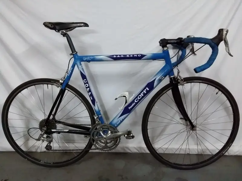

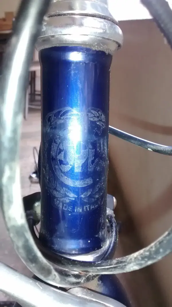

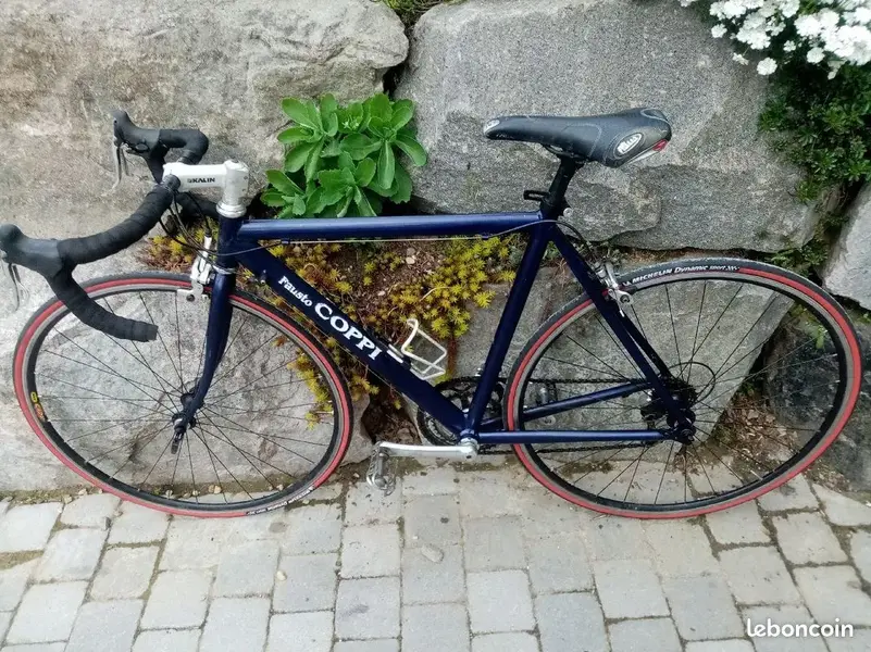

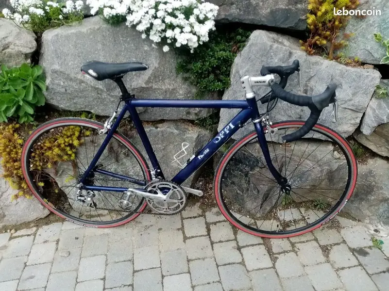

As I said in the title, I'd like to know what model it is. There are the seller's pics at the end on the message. The serial number of the bike is A9B10986. The group is part Campagolo Veloce and Mirage, there is a Shimano cassette (9 speed), 2 chainrings. If you know what bike it could be, it would be nice !
Good afternoon !
Here are the pics (I'll put other ones I took some minutes ago) :
