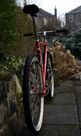

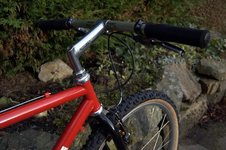

And some pics of the final weight weenie build...
After our Dunkeld ride, I'll move it away from being a weight weenie and more towards a regular rider that I'm comfortable with... that'll mean wider bars for sure. The rest, we'll see...
very nice result! great colour of the frame. goes well with the black fork, silver parts and gold ano accents
