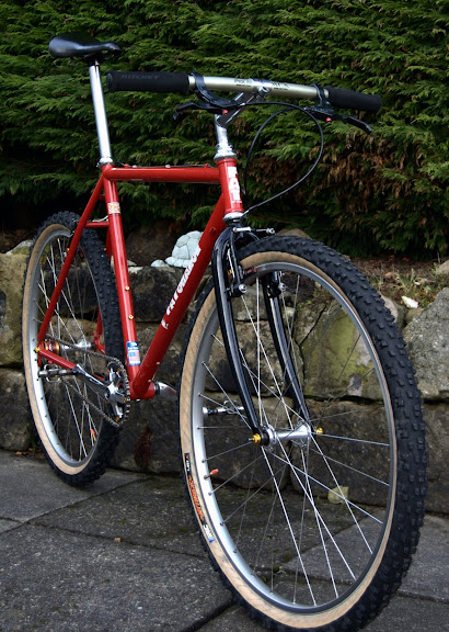

OK, after chucking some parts at this before Christmas and ending up with a very disappointing 22lb+ bike, a strip down and stricter diet was called for. Pass the laxatives nurse!
Spreadsheet final weight is 19.3 lbs, my bathroom scales say 19lbs - either way pretty happy.
Initial Build

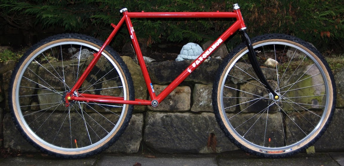

6,164g as pictured above, breaks down as follows:
Code:
 - Frame & Headset (FSA Duron) & BB 2386
 - Fork & Crown Race                 732
 - Salsa Seat Clamp                   33
Frame and Forks Total               3151
 - Superstar Ti Skewer            23
 - Mavic 231/XT M732 Hub        1005
 - IRC Mythos XC 1.95 F Folding  491
 - Maxxis Flyweight               87
 - Spacers                        22
 - Token Lock Ring                 7
 - 17T Surly Cog                  44
Rear Wheel Total                1679
 - Superstar Ti Skewer             21
 - Mavic 231/XT M730 Hub          735
 - IRC Mythos SXC 1.95 F Folding  491
Front Wheel Total                1334
This is for the Dunkeld ride at the end of January - a few of us are weight weenie-ing. I know it won't be competitive with the Alu frames, but I'm enjoying the process.
It won't be a period correct build (hard to resist those £15 44g Ti skewers) - I'm also on a budget so re-using what I have kicking around in the man cave where possible. It's looking like biggest deviation will be a set of V brakes.
Hoping for 19-19.5 lbs. Sub 19 might just be a possibility.
Biggest revelation so far? How much weight you can save with those Flyweight inner tubes - A truly cost-effective way to shave those grams.
Looks pretty light, and removing half the "Wicked" logo was an innovative weight-saving idea!
It might be hard to ride without, you know, a drivetrain and brakes and stuff though. Just sayin'....
clockworkgazz":sz1wpfm3 said:
looking good but not the v's please :lol: :lol: :lol:
Come on, meet me half way here... I did take off the Maggies after all :)
Jamis Diablo":sz1wpfm3 said:
I hope the 15BP skewers don't save you some more weight, teeth-wise.
Aye, website says they are MTB specific, so they should be OK.
Fit the Vs and saw off the canti hanger on the seat stays and that's more weight saved.
EDIT: for those that need an indication of when someone is being sarcastic :wink:
