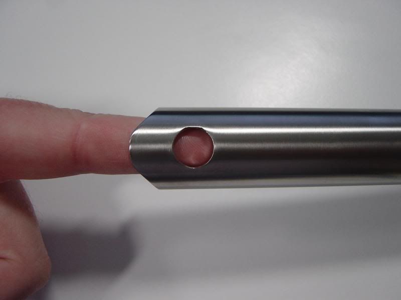

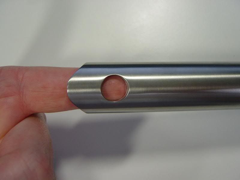

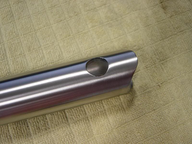

Well about three hours work later, I am now in a position where I reckon I can get this post looking good again – especially after it gets blasted :D

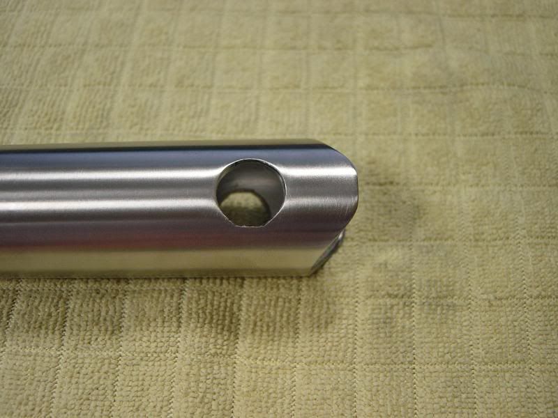

First I got a pin punch and carefully tapped down the raised / damaged areas, followed by some careful work with the needle file and then the emery paper.
Once the damage was back level with the original form, it defo looks like the tool used to lever the hole was a flat bladed screwdriver or other square edged shape :facepalm:
Front :
Rear :

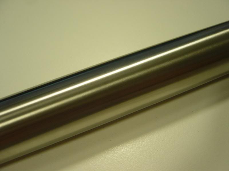

I also spent time refinishing the post and removing the cable / saddle bag rub. As this was all near the top it won’t alter fitment of the post into the shim / frame.

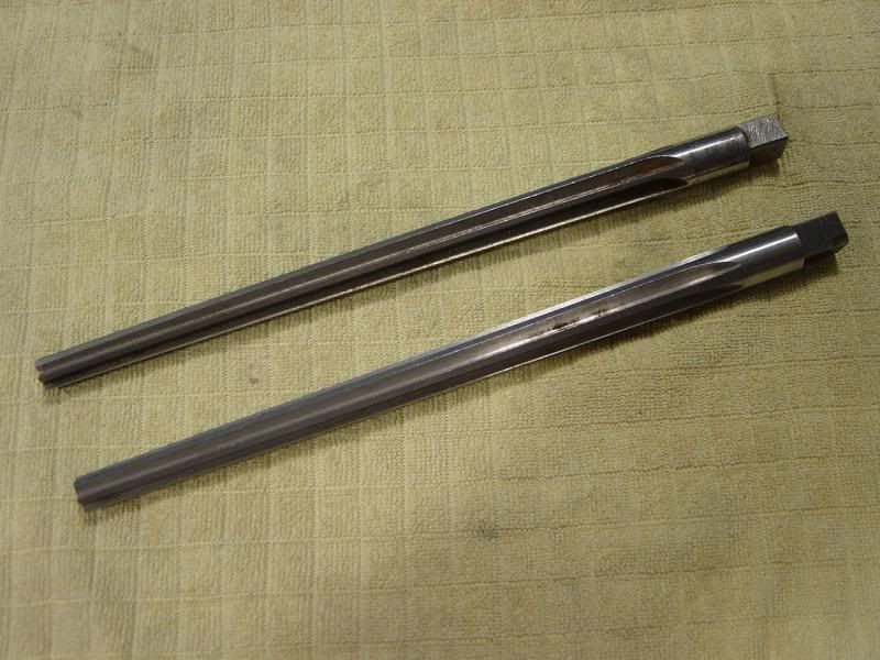

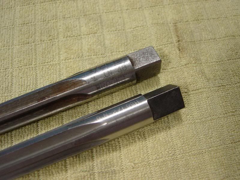

I was going to get Intrincycle / Rampage to machine the hole bigger to totally remove the damage, but after searching though my ‘yet to be sorted’ box that I liberated from the factory shut down, I found these that should do the trick :
They are taper reamers so I will ream both sides just enough to remove the damage and then enlarge the smallest hole to the same size as the largest :D

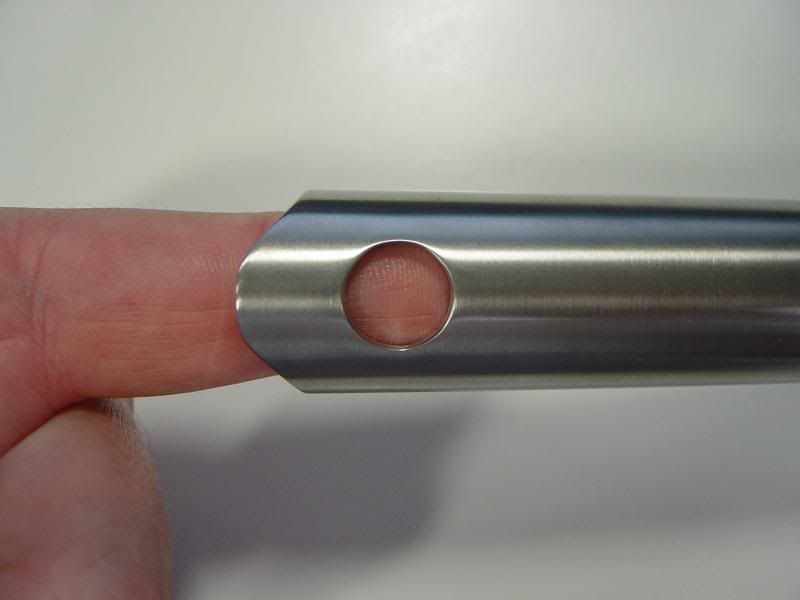

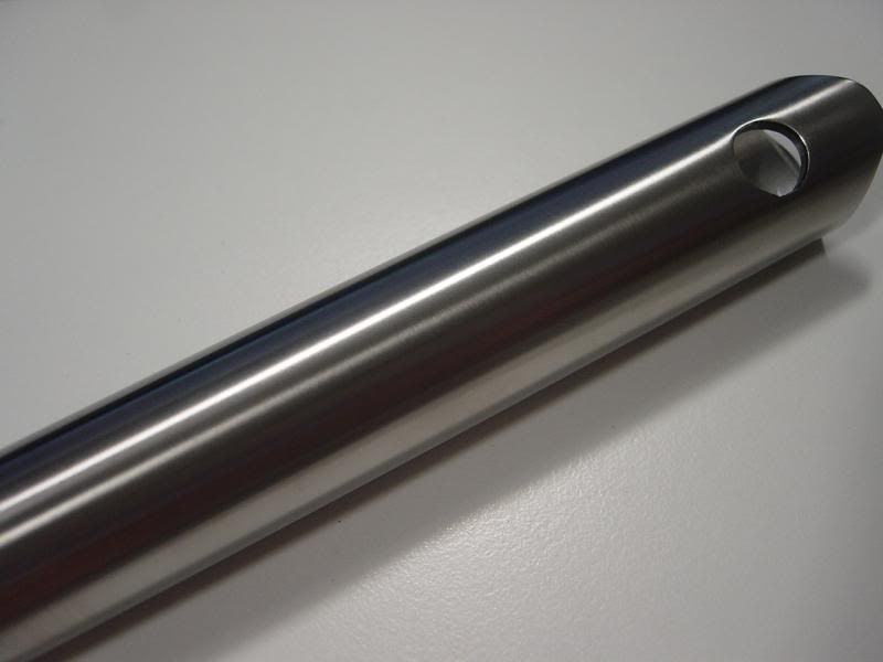

Anyhow, I have reamed the post now and it came out really well, I will try and get some pictures and post them up tonight :D

Back to the Yo post, the cable rub was removed by careful work with the needle file and then emory, the trick is to level the surface to remove the edges that catch the light and alter the reflections. It's true that the wall thickness in that area will be slightly reduced but the diameter (other than strength) is somewhat unimportant there as it isn't clamped or doesn't have to mate with anything :D

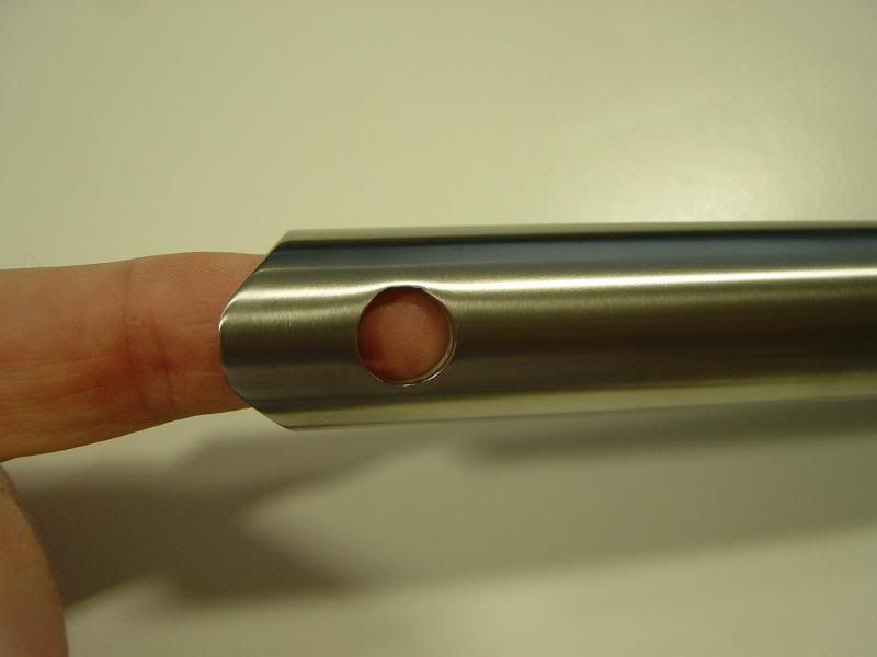

Nice clean hole edges now :
Front :
Rear :
Both sides now measure 11.90 mm so I will draw up a new pin at 11.80 mm - this maintains the same ratio to the nice fitting 11.00mm USE pins (rather than the poor fitting modern replacements).

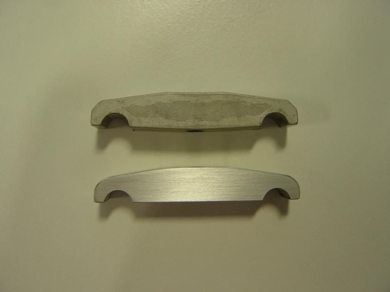

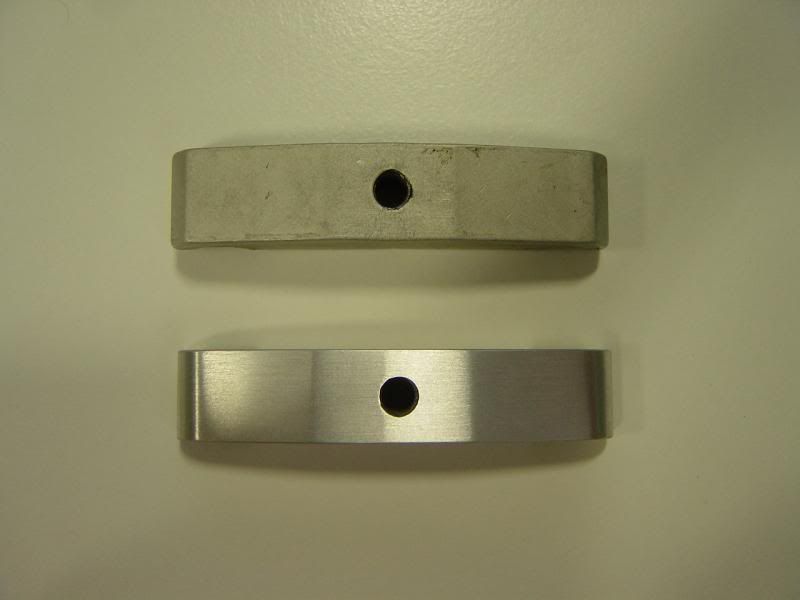

The distorted clamp mods :
They should look OK when they are both completed and done in fresh purple with the other bits :D
