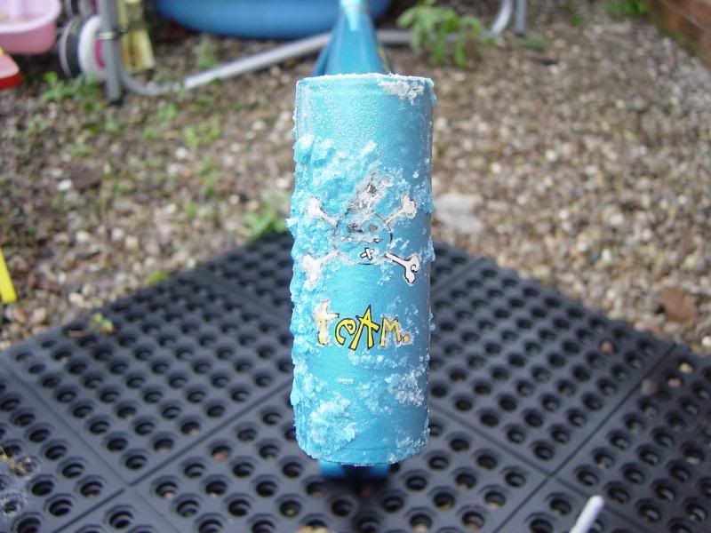

The local auto body paint suppliers came to the rescue with some paint stripper that actually works on the frame 8)
I only had 10 mins to try it so it's not finished yet, but at least I now know I can get through the paint :D
WD :D

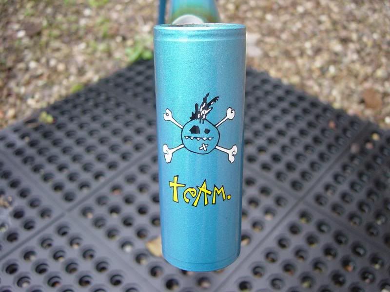

I got a bit of spare time today so managed to strip most of the front triangle :D
I found a few bits that needed sorting but generally everything is looking great 8)

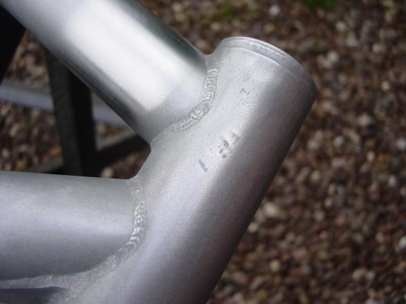

The head tube area had an 'extra' layer of cream primer under the paint, I haven't found this anywhere else (yet ...). I didn't know why at first, but in hindsight, I suspect it was filler primer to hide the cable rub - only one of these had rubbed the latest paint job, the others were invisible so the filler primer must work ! :

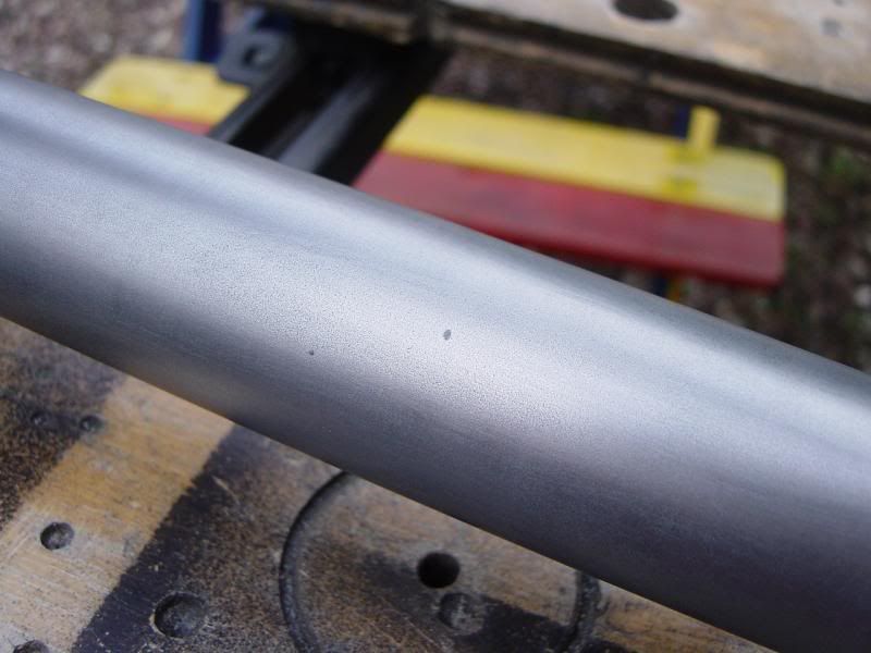

This I could see through the paint (the dimple) :
So it was expected and already on the list of things to fix - not sure what it is ?

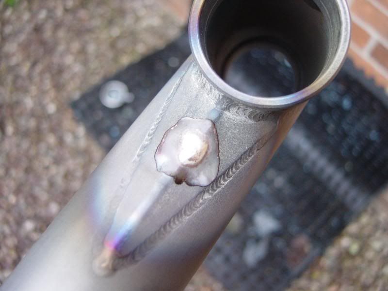

This is a bit weird :
But an easy fix.

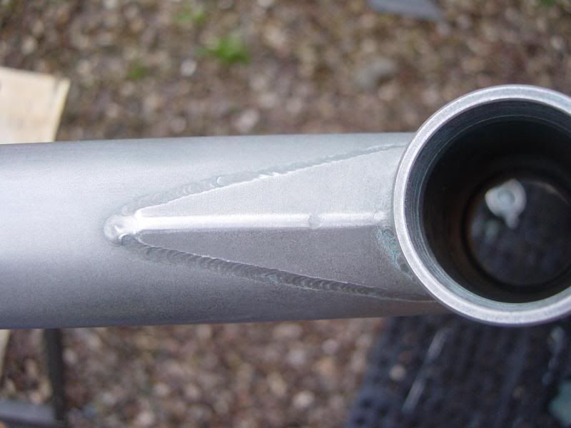

I had a little bit more time than expected so managed to fix two of the above before packing away.
I used the same rods that I used on the bear valley :

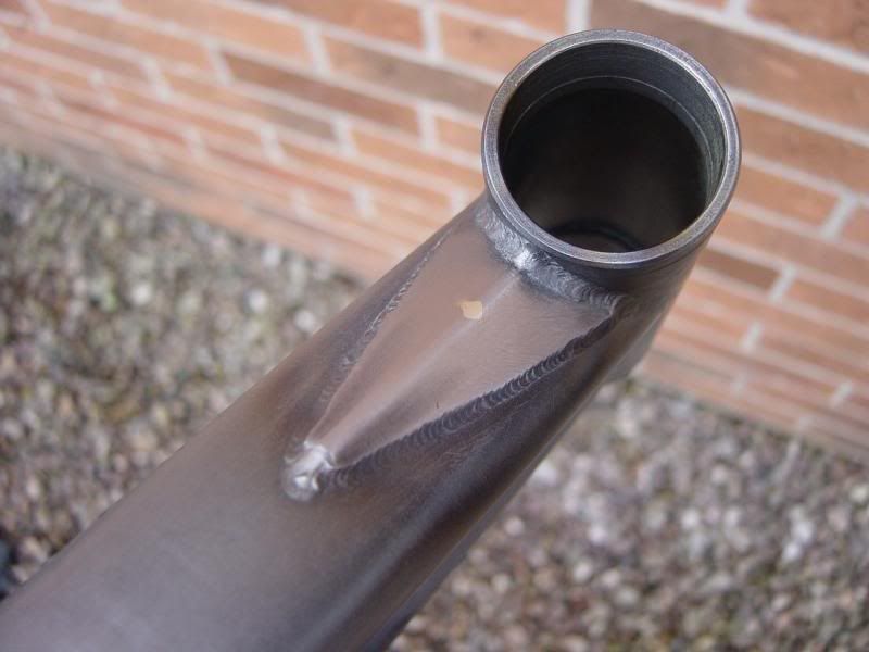

I forgot to take a picture of this immediately after brazing so this is part prepped :
The gusset :
And after :
It was actually quite hard to get the camera to pick it out (took about 20 shots to capture the above !) and I gave up trying to capture the down tube repair - it's that small it's difficult to see with the naked eye now it's dressed :lol:
The inside of the head tube and bottom bracket are really good and clean - no rust / pitting etc. If I can get a good shot I will because the evenness of the weld penetration inside the head tube is remarkable 8)
