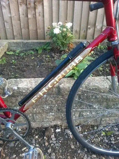

I haven't seen anything like my F H GRUBB down tube logo. White and gold lettering one side and gold and white the other. Think it was hand painted. Frame number 2144.
Nobody has managed to date it so far.

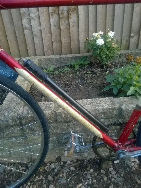

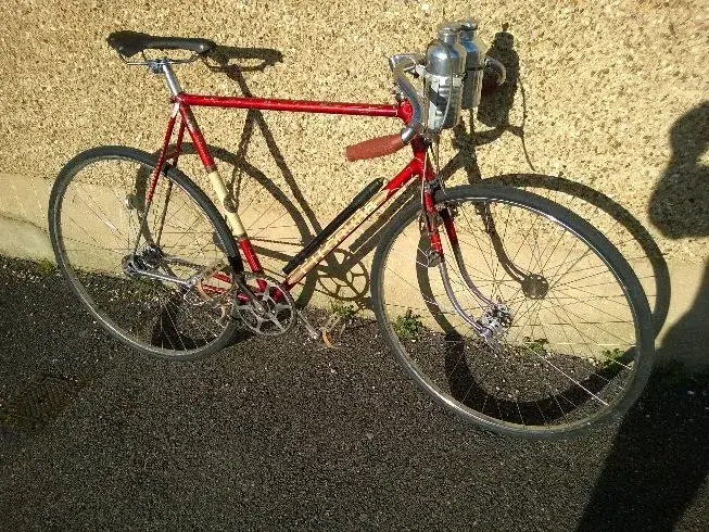

Norman said 49 at first then changed his mind. The previous owner said it was 38 which I doubt. 46-7 could be? Paint on the frame is all original. Very light and rides well.
Simon.

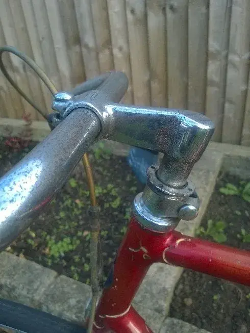

I found out this stem was patented in 1938 and hollow construction. May not of been original to the bike. Chater Lea headset and bottom bracket.

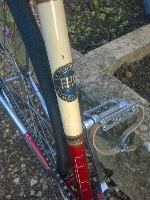

Reynolds 531 has been got at as well as the bonderised decal above it. Can just make out rustproofed on it.

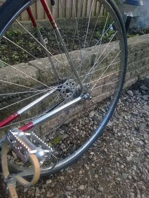

Sadly one mudguard braze-on has got damaged in its life time. Wheel wing nuts are rare Sturmey Archer nuts.
