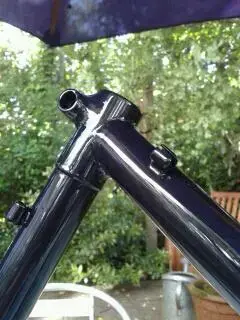

A quick update as I'm the owner of this frame now...

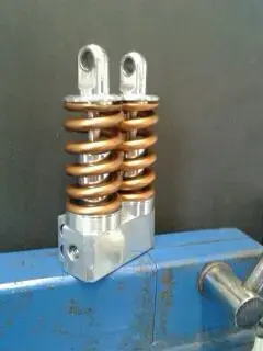

I have been doing a ground up restoration of this bike over the last few months. The reason the back end was flexy is the shock unit was broken, one damper shaft bent and the other snapped in two! also the mounting bolt had sheered off and been botched with miss matched parts and the bushes erm, bushed.
I have had the shocks stripped down, new shafts made, shock body refurbished 'one was ovalised', new seals, and bolts. New bushes machined and replaced the bolts. Springs painted and rear end polished.
The frame has been bare metal sprayed in a colour match blue (couldn't find the original code)

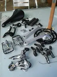

Parts going on the final build are...
NOS Spinner unicrown cromo fork
NOS Allsop Sofride stem
LX hubs with Syncros rims
Suntour Chainset
Suntour front/rear mechs
Suntour shifters
Suntour levers
Dia Compe cantis
Zoom Brahma bar
Ritchey seatpost
Ritchey seat
Ritchey tyres etc...
I have not slaved to keep the bike period, but done what I usually do and make a custom bike to my own tastes.
