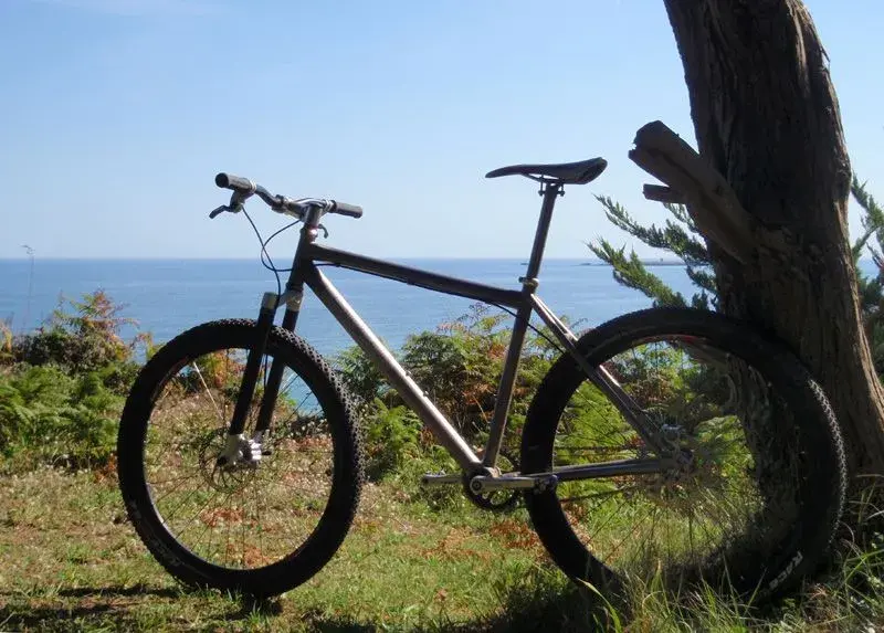

Eriksen #64 SS

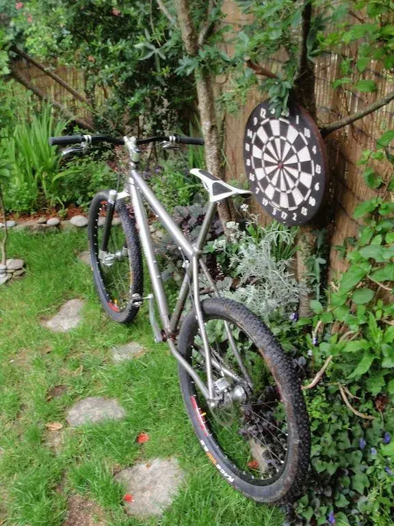

New post, tires & saddle
Ti post, cheap from fleabay
Conti RK Supersonic
Charge Knife
charge knife is good, but not great.

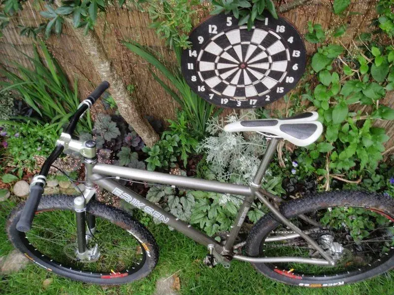

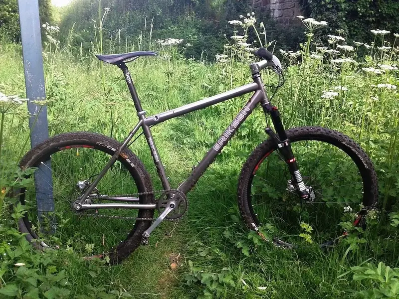

here's a couple of (crappy) yard shots with the new saddle, Italia storika "hi-tech"

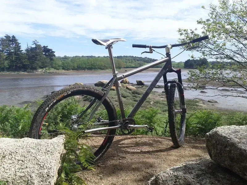

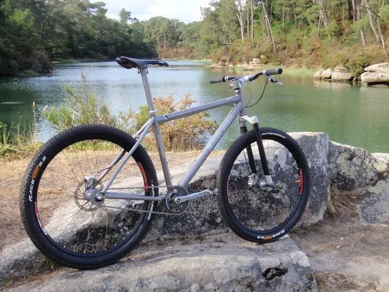

some parts have arrived :) :
DT Swiss forks
Skyde Ti bars
Fork: DT Swiss XMC 100
Headset: Chris King
Stem: Thomson
Handlebar: Skyde Ajocoda
Grips: WTB
Brakes: Magura Marta
Crankset & chainring: Middleburn RS8 / UNO 36t hardcoat
BB: Stronglight Ti
Chain: Wipperman
Sprocket: WTB 18t
Pedals: Ritchey Paradigm
Hubs: Hope Pro II SS
Rims: Salsa Delgado Race
Tyres: Conti Speed King Supersonic / Conti Race King SS
Saddle: Italia Storika Hi-Tech
Seatpost: Ti noname
Seatpost Binder: Salsa

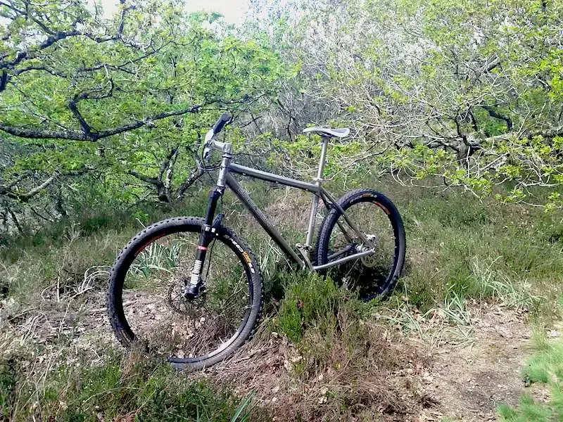

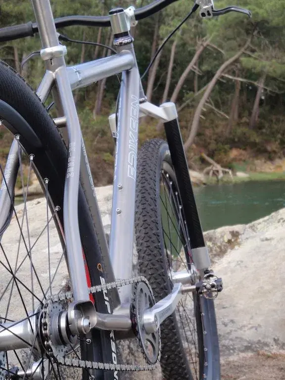

Headset: Chris King
Stem: Thomson
Grips: WTB
BB: Stronglight Ti
Chain: Wipperman
Sprocket: WTB 18t
Seatpost: Ti noname
Made in USA: Frame, Headset, Stem, Seatpost Binder, Sprocket
Made in UK: Hubs, Crankset
Made in Germany: Brakes, Tires, Chain
Made in France: BB
Made in Italy: Saddle
Made in Taiwan: Pedals, Rims, Seatpost
Made in China: Bars
Swiss made: Forks, Spokes
some day i'll change the rims for a pair of mavics
i ordered a USE seatpost (made in England?)
can anyone think of a brand of spd pedals that are made in Europe? what about bars? stem? Ti sprocket?
and now a USE sumo post, the saddle rails kept on slipping in the cheapo made in china (J&L on ebay - i wouldn't recommend it for riders over 70kg)
also, i dyed the white leather - too fragile for mtb!
