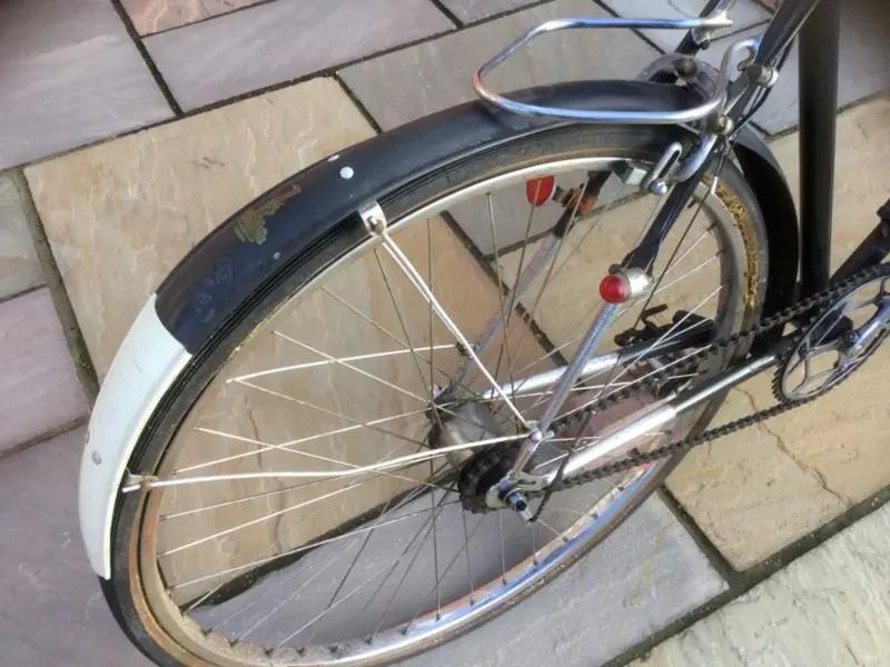

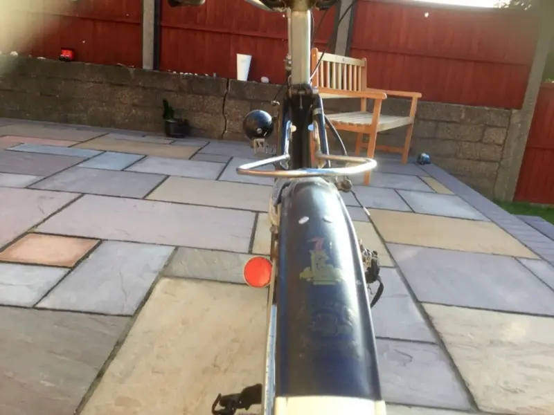

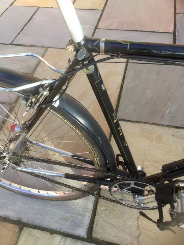

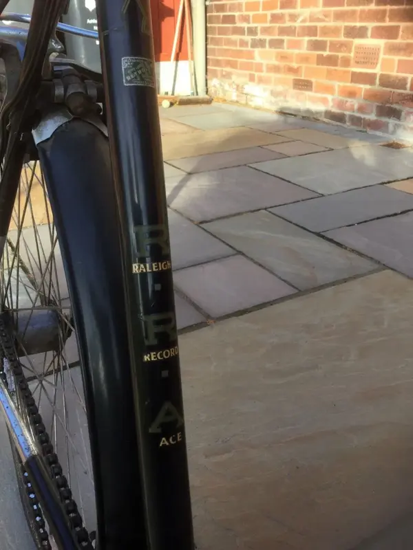

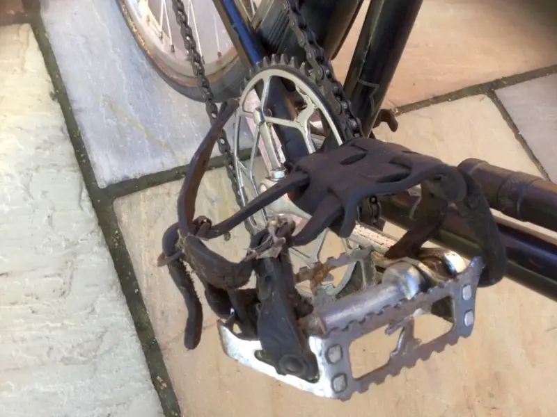

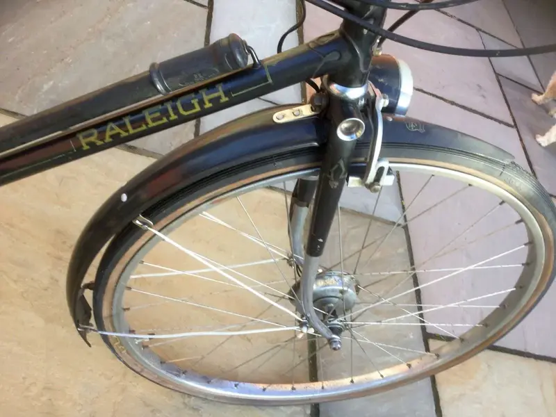

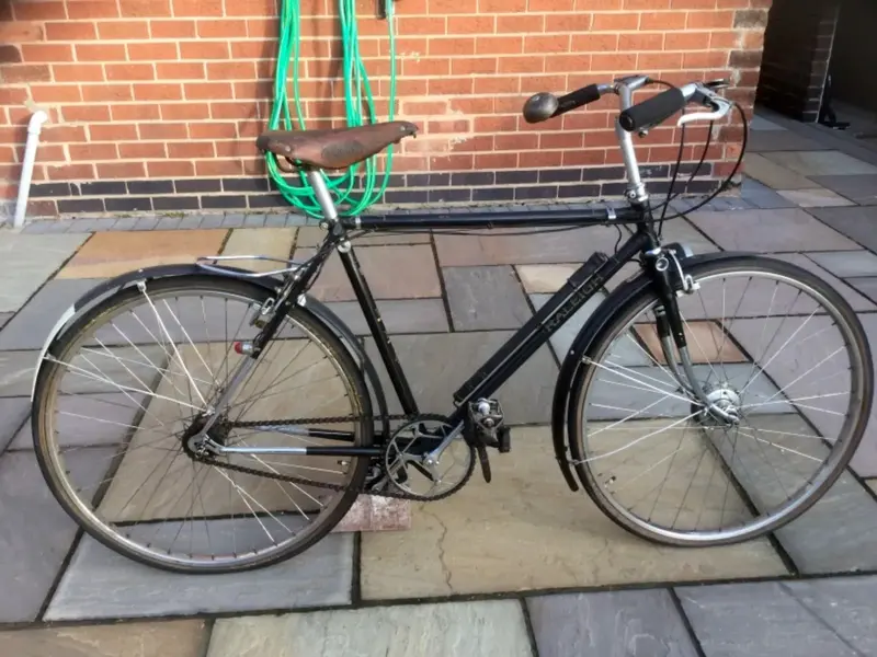

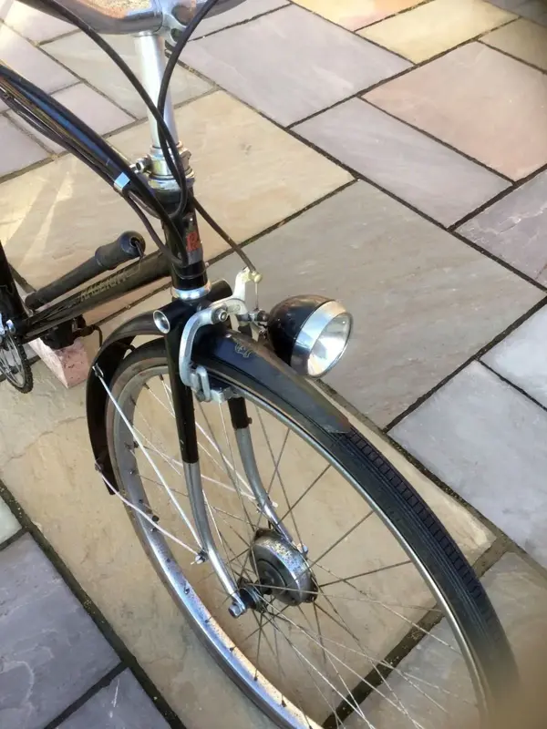

If you're talking the Rolls-Royce, what about a 1948 Model 26 Raleigh Record Ace in touring spec, I picked this up locally a couple of years ago, I've since put drops and RRA stem back on it, removed the dynamo and rebuilt the wheels with Constrictor alloy rims and Airlite front hub.
Raleigh sold the RRA as a tourer option but this one was (I believe) built as a sports model and later converted to a tourer - and I've converted it back!
531 double butted frame, forks and stays, original paintwork with all special RRA fittings, SA AM 3 speed hub. Weight is approx 26lbs now.
These are the sellers photos from Ebay, I'll post some photos as it is now when the weather improves - I didn't remember to take any when I finished it!
