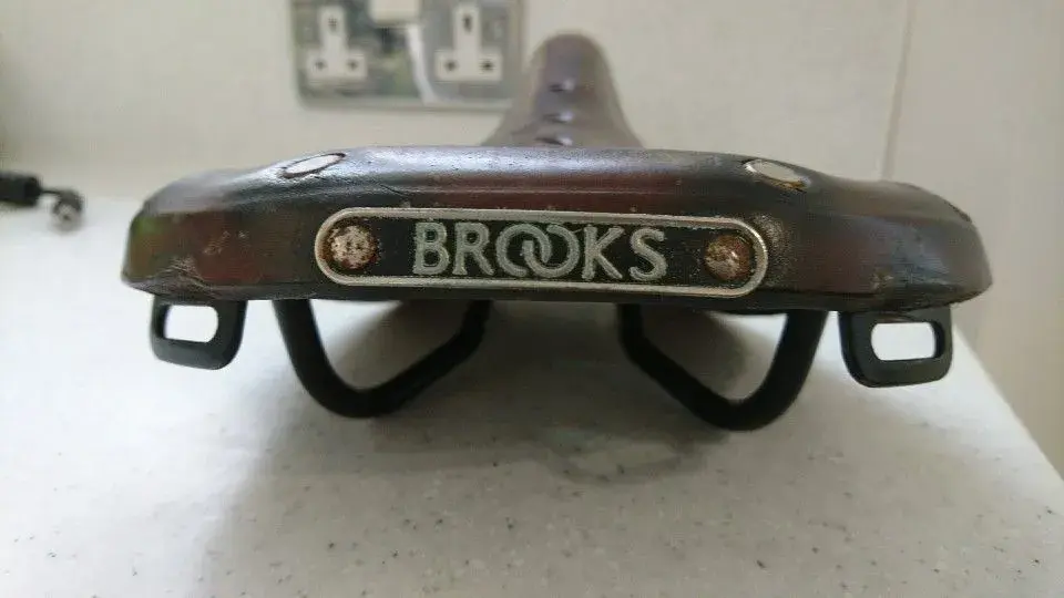

So quick update, the original saddle that came with the bike was not comfy for me at all and so required a change. I had nicked a saddle from a mtb that wasn't doing anything for a while which worked but I managed to pick this up today
