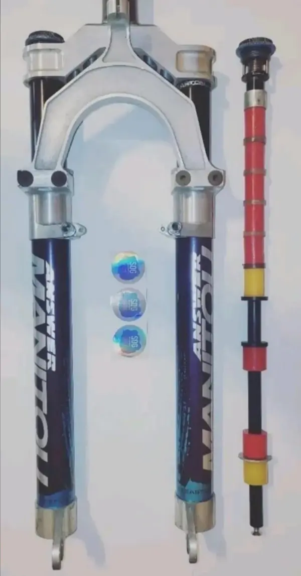

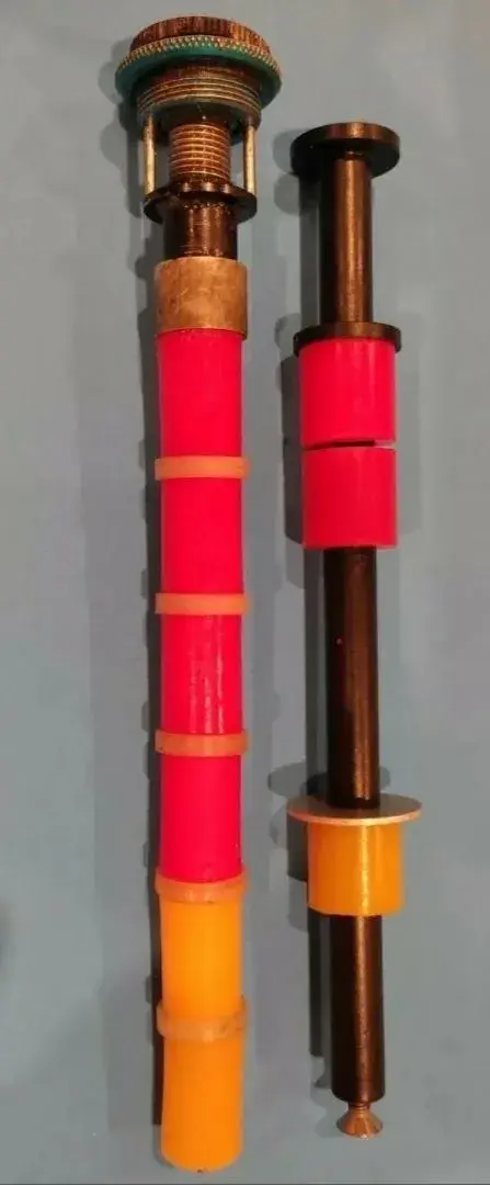

If the photo depicts all of the parts you have for the fork, you'll likely need more the (formerly) white plastic spacers that go between the elastomers. If my brain serves, there should be 6 spacers per leg for the Manitou 4.
5 per side to be precise. With the normal setup.
I do have these spacers as well as repro parts
The 6 spacers are there between the yellow elastomers.
Yes but only if you had the additional +1 Elastomer per leg for slightly longer travel. 1 year later, the MANITOU EFC had 6 spacers and therefore 7 elastomers per side stock. Normally its 5 spacers per side.

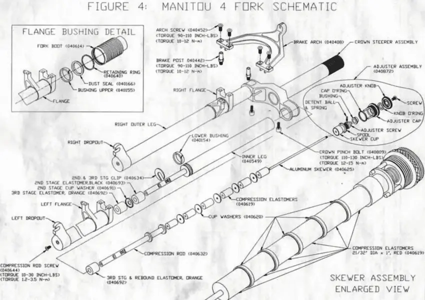

And here is also the excerpt from the M4 manual:

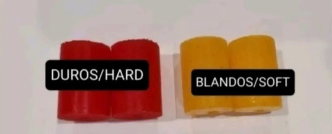

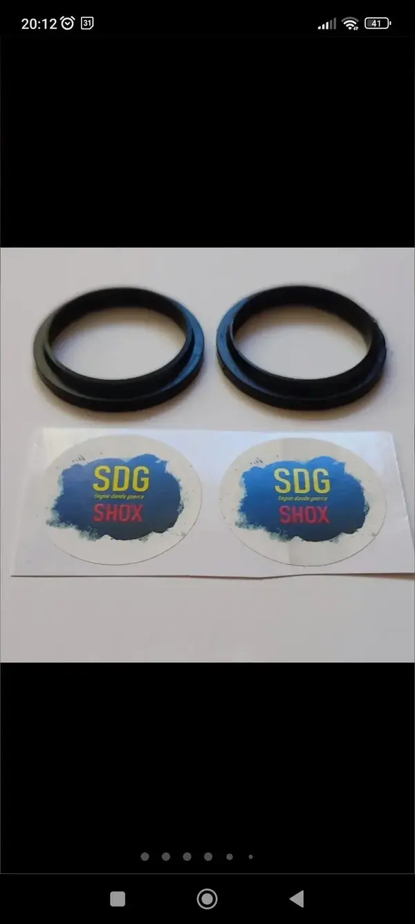

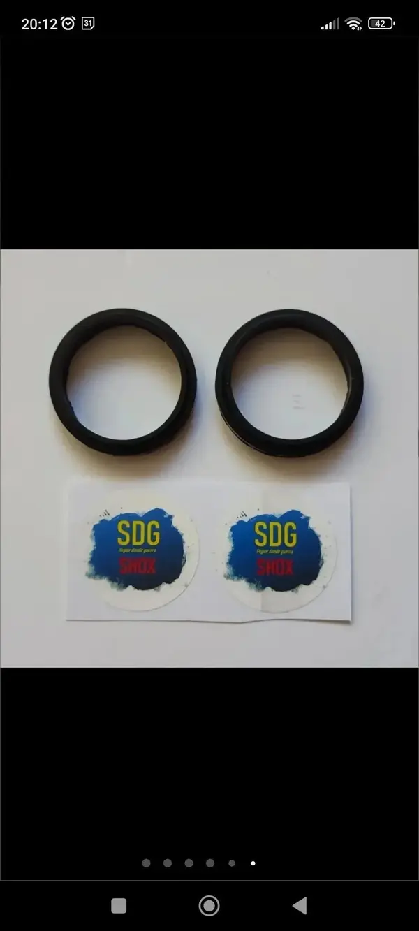

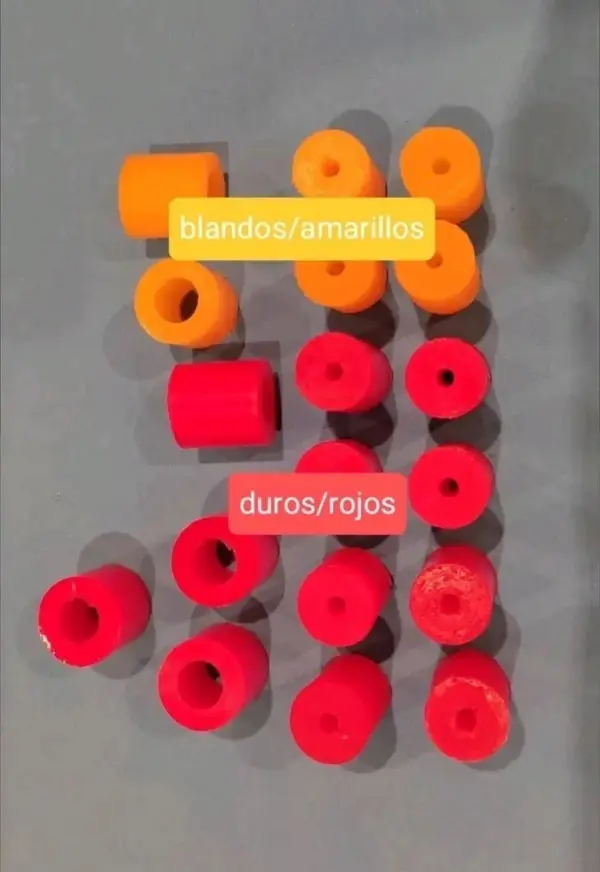

happy new year everyone, we want to help, we have elastomers for those wonders, we have a full Answer Manitou 4 kit and dust covers
