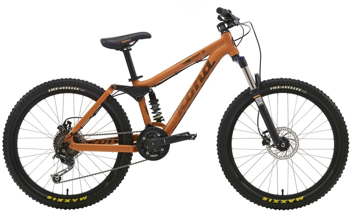

-The classic seatstay pivot and rocker ones like this Alpinestars morphing into the classic 90s bikes like the Kona Stinky.

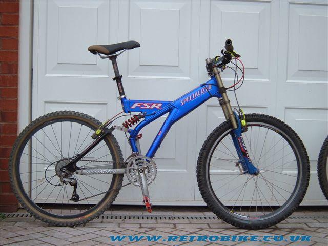

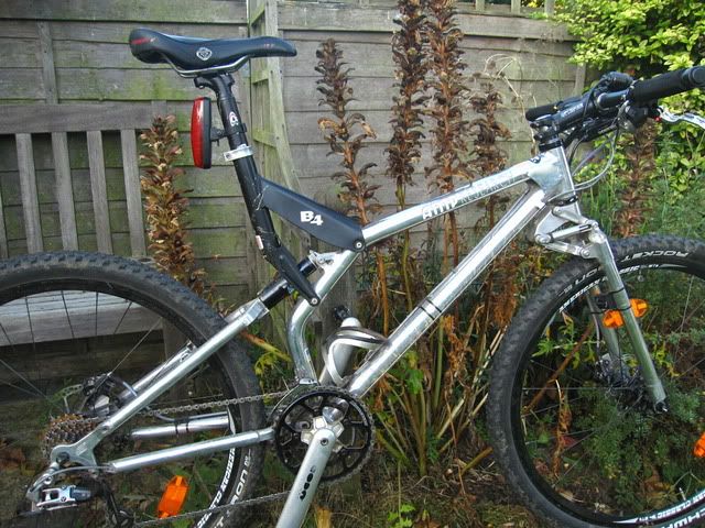

And the Horst link rear end from AMP which became the Specialized FSR.
That FSR looks nothing like the AMP setup ?
True, but it uses the chainstay Horst link, and evolved through the rigid mounted shock (AMP B3 + B4)
and the AMP B5 frame with the rocker:
Which was licensed etc and evolved into the 1997 FSR:
