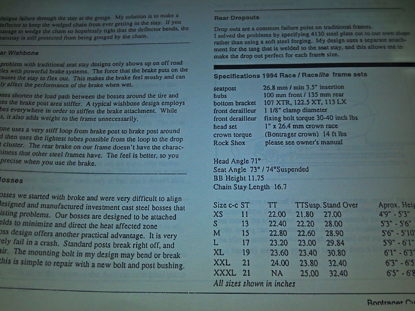

Thanks Bonty 98. Have just downloaded both '94 catalogues from the archive, but they're both in German! Therefore, although there's a table of numbers that I can see, I'm still none the wiser if these frames were built assuming they'd get a suspension fork or rigid fork on the front end? Could it be either and im right to try to find out, or is it a completely irrelevant point and I can just stick any old fork on it?
I've been advised specifically that if the frame was built for suspension forks, sticking a standard rigid fork on it will completely balls up the handling. Is this correct?

I dug through my dealer book
Thanks Hollister - that looks really useful.
Am I reading it right, that depending on the seattube angle determines whether it's been set up for suspension or not?
Assuming that to be correct, how does one tell which one it is? If I'm missing something really obvious here - massive apols!
Measure the seat tube centre to centre, that will give you a size, then measure the top tube centre to centre - whatever that distance is will relate to the above chart and tell you whether it is a standard or sus corrected frame.
Eg. If the seat tube measures 17" and the top tube measures 23.2" then it is a standard frame.

Am now confused....
My seattube very clearly measures up at 17" (or a Large frame) - this is centre to centre and is bang on.
Using the exact same centre to centre technique, my top tube is shorter than both of the manual columns! My top tube is very slightly more than 22" but not quite as long as 22.25" (again centre to centre) - therefore, am still none the wiser. It's certainly not either 23" or 23.2"! :?:
Could it be a '93 frame that was sold "late" and with '94 decals in place by some chance or something like that?

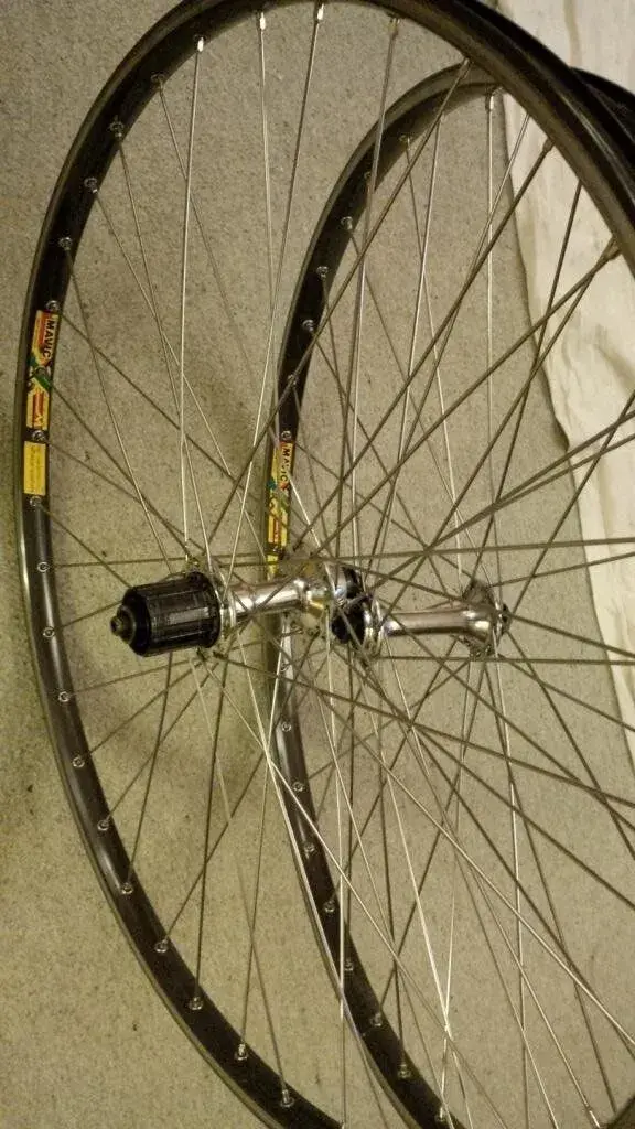

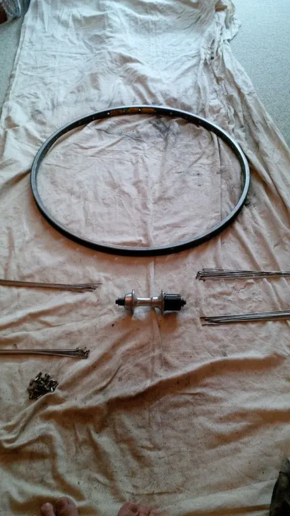

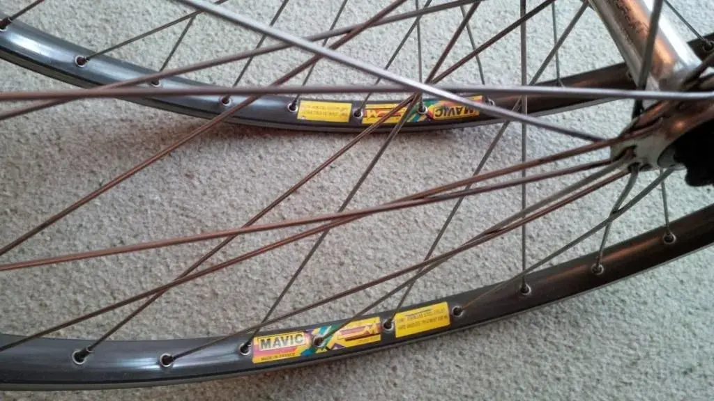

Okey dokey - first job is now done... Managed to source some lovely Deore XT / M231CD wheels, but they were covered in 20+ years of oil and grime. Had a good go at cleaning as they were, but I hate it when you can't clean the eyelets and around the hub flanges as you just can't get near to them with spokes in place - full strip down and rebuild was the only way to get those hubs & rims really gleaming again....
