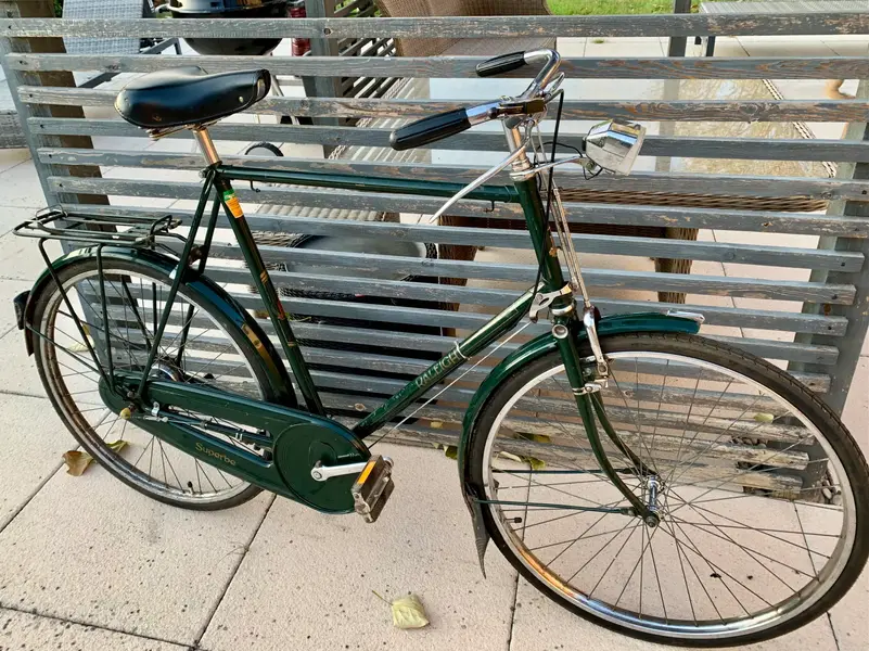

Hi all, I saved a 1982 Raleigh Superbe from the dump and I’m steadily working through a refurb. I have it rideable and it’s looking better already.

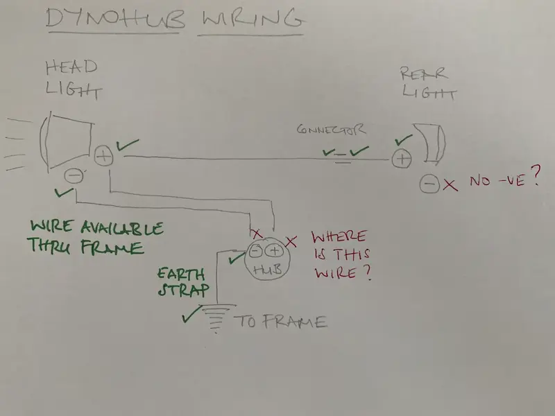

I am looking to get the dynamo working, but electricals aren’t my strongpoint! I am struggling to make sense of the wiring as it is routed through the frame and one end of the wires from the headlight is missing at the dynohub (rear wheel set up). I am wondering whether I’ll find it when tackling the bottom bracket overhaul.
Anyway, my hypothesis on how the wiring was connected up in the factory is attached. Would be very grateful if someone could validate that it will work. Thanks!
