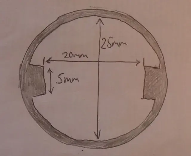

Unfortunately the sun tour remover is too big to fit the slots, if I could get one of these it would still need to be re machined to fit, I was just trying to find out if the DA ones were still for sale anywhere or whether I would have to get one made.

This might be the one you are looking for. Inner diameter ~25mm, distance between inner surfaces of the lugs ~20mm, ~5mm long lugs. It is a Dura-Ace one. Let me know if it is the right one for your freewheel.
Nick

That is exactly right :D
Just used the vernier and got 25 outer 20mm inner and 5.6mm slots.
