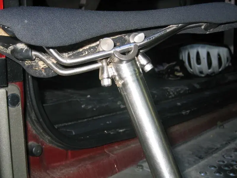

i have a king kahuna calling for a 27.0, but had a beautiful boutique ti post (by torque titanium fabrication) in 26.8 from another bike that i simply had to use.
a trip to the local hobby shop produced a thin sheet of brass in precisely 0.1mm thickness...carefully cut to a single wrap around the post makes for a 27.0 diameter with built-in anti-seize properties. a bit of grease helps the very flexible sheet stick nicely to the shaft...surprisingly easy to get in and out of the frame without it moving around.
two years and counting without issue.
