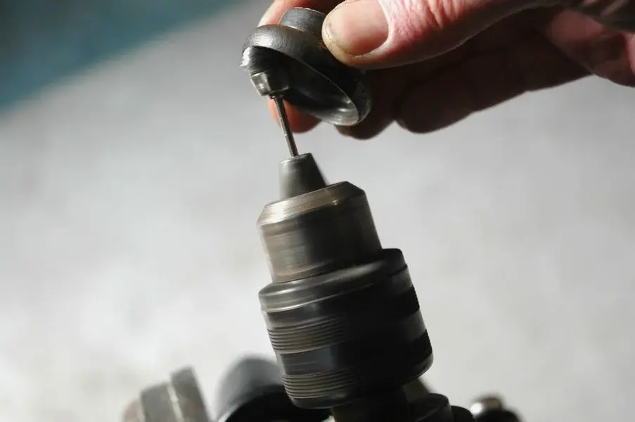

"So i would say a drill in a workmate is fine, PROVIDED, its in there well and it has a trigger lock."
Good luck with that one today. I'm hanging on my two Swiss made Bosch CSB-470-RLE because the spec. is precisely what
you stated above. Seen in action here, put in a bench vice.

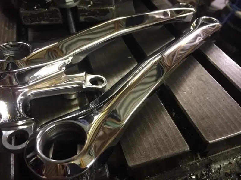

Not heard of that - is it a cutting polish? Using autosol as I use it on exhaust tips, but always up for a better suggestion.
yes just a bit finer than autosols (aluminuim version) polish which is also finer itself than normal regular autosol. so good for the final mirror finish.
If somethings bad i do the plain autosol first to get the worst off then the mothers. i do have all the buff wheels and polish bars for a bench grinder but its such a messy process but good if the metal needs more working.
