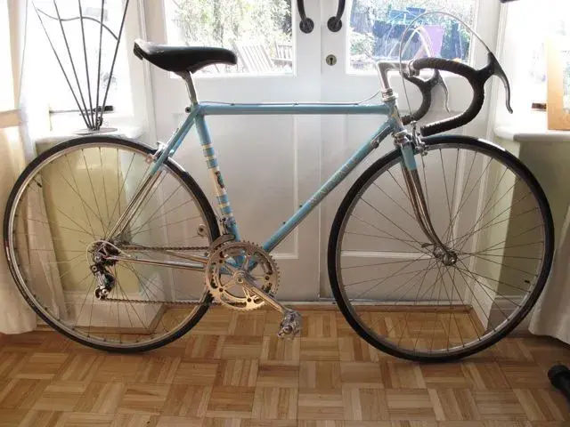

Edit: on your pic you have marked L for the R, and R for the L. If your pic is correct, your part A's need to swap sides :-) If its just your markings on the pic that are wrong ie you know the above already, then you are up against the issue of part A being for a different type of boss. I remembered when out riding before what it was that caught me out, it was my own part A. Some pass right over the boss, and some seat on the boss. This is where the extra height comes from that stops the tightening screw doing its job. Had this issue on my Paganini fitting synchro's in place of friction. Luckily I had bits to "make it fit". Twas only the R hand side that caused issues :-) Later Betty, yours Laz.
Many thanks for all the good tips.
Looks like I may have a bit more work to do now I've just read the suggestion that I've got the part A on the wrong side. However, I switched the D-locks over last night, to the naked eye they look the same length but switching left and right was all that was required to get the gears functioning.
Very happy. Just need to track down a solitary brake block now and I'll be able to take her out for a spin.
Hi again Betty :-) WOW doesn't she look beautiful ... I am impressed, stunning, more stunning that I thought she'd ever look :shock: . Disregard the tip re: parts A if they work now, the odds are you "have" done it correctly (looking at the pic) and just labelled your pic wrong.
Happy that switching the D bolts has done the job. I always say if it works it works, and thats that :-) What brake block are you missing ? An SR version ? Just the block or the shoe aswell ? Got lots of stuff here. Take care Betty, and I'm sure you'll enjoy the ride from this frame, and get more than a few passing glances as you sail by. Yours Laz.
