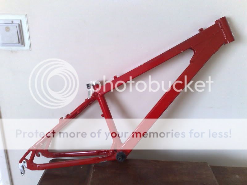

Wanted to get something half-decent together for the kids to pootle around on with us at weekends.. if I get this right and they like it, I'll go on the hunt for another small frame and go again 'til all 3 of them have a 'nice bike'..
Going to be built around the little red frame I got off here a couple of months back - which is getting painted/powder-coated soon as I can arrange it
It's being built single ring up front and 7 at the back (maybe 8) with XT cranks, rear mech and V brakes. Probably DMR pedals (or similar).

What I would suggest is getting the cranks shortened. So often you see kids trying to paddle 175's around - it's like us pushing 250's - they bend their knees to much and cannot get leverage at the top of the stroke.
Highpath Engineering did a set for me for around £40
I'm not having my XT cranks shortened.. would have to get something else in... see where you're coming from though.. 8)
Will get Shimano bb..
They've not decided on colour yet.. #1 wants blue, #2 doesn't have a clue what she wants and the boy is a few years off a 26" wheel...
Up to 100mm travel fork should be a pretty safe bet??
yes 100mm travel fork should be fine for that frame, maybe get something a bit harder so theyre not losing too much energy through the forks. also, have enough parts to change around i.e get them to test it on every part change until they are comfy with it :wink: (shorter/longer stem, different bars, seatpost height)
edit: also, i reckon if your doing a 1x7 setup the ring should be about a 32t, get some nice fast rolling tyres (unless doing a lot of off road) and just generally try and make the bike as enjoyable as possible
