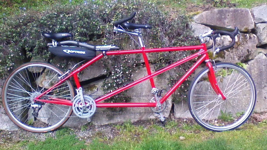

Some Tandems tend to wallow horribly when putting the power in . ( power transfer)
We found it out when trying out the beginners models.
In the end I purchased a Mtb Cannondale frame . Had it built up by Mercians .
I ran out of bottle long before road holding became an issue.
Over sized alloy main tubes . Rode as if was on rails .
26 inch mtb wheel size .
Maxi car front hub . Campagnolo Tandem rear . Sunn rhino rims . All bomb proof .

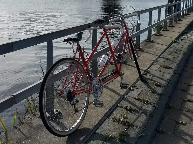

I always wanted to try a tandem. Mrs non-fixie didn't. But when I finally found a nice Vittorio in our 64/52cm sizes she was a good sport, and we did a few rides until we got the hang of it. After that we got sidetracked by new solo bike acquisitions and kinda forgot about the tandem.
The biggest challenge, I found, is handling the size and weight of the thing. No way I can carry this thing up or down the stairs, and even getting it on the work stand is a wrestling match I just barely win.
When I picked it up at the seller's it went in the back of my Jeep WJ. Had to remove at least one wheel, maybe two. Don't recall.
Braking is mediocre at best, even in our flat country. We got pretty good at yelling at other people. "Coming through!"

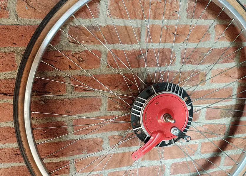

I recently found a cheap wheel which just happened to have an Arai drum brake attached to it, which should calm things down a bit. Still have to mount it.
