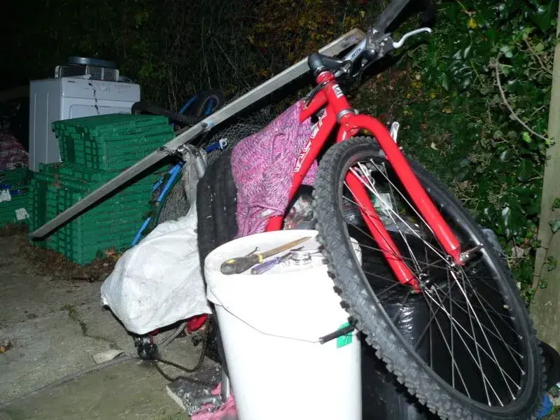

Dendy had a good idea for his stuck on his kili. If the seatpost has the clamp attached take the steel rails from a knackered seat and weld a piece of steel metal to it for a ridiculous amount of leverage. Should work a treat especially with penetrating oil first.
I've nicked his picture to show what I mean, hope he doesnt mind:
The trouble with using big levers is you can shear the post and leave some of it way down in the seat tube.
