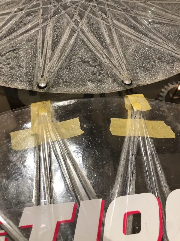

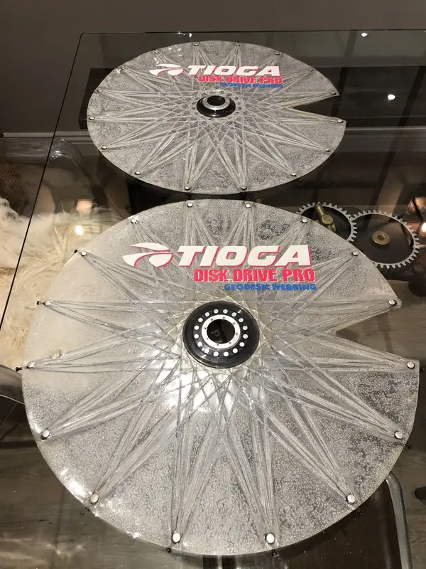

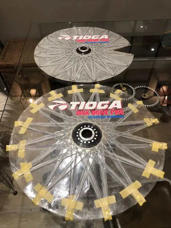

I started cleaning a disc drive up a few years ago. The glue in between both sheets had completed failed, so I set about cleaning the dried glue off to see if I could bond the sheets back together. Cleaned up one side but that’s as far as I got :LOL:
Old, dried glue shines again with heat. I also did the same a long time ago, great job and it is impossible to delete everything. It warms up, but it is important that you use Rim. It is easier to work with. I have several NOS with the same problem and when I can I will try that heat idea with one of them.
