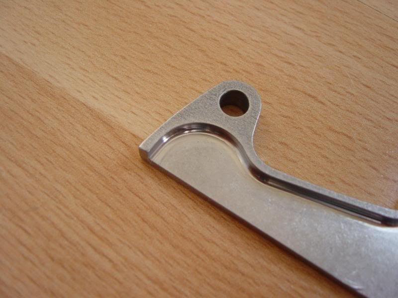

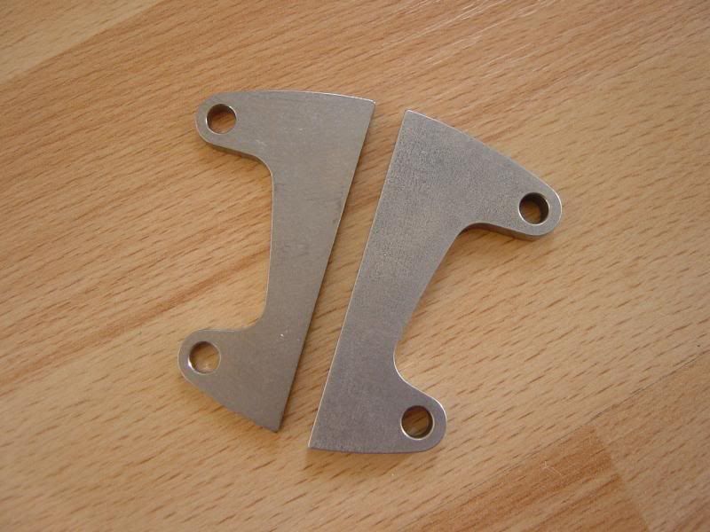

Make your own for the rear , it's just a piece of steel plate shapes with 2 holes in it.
Braze it on and hey presto , bear in mind your frame will need painting afterwards though , if in doubt use someone like Bob Jackson or Ellis Briggs (or a local to you framebuilder ) to put one on for you , will probably cost about £60 > £70 .
