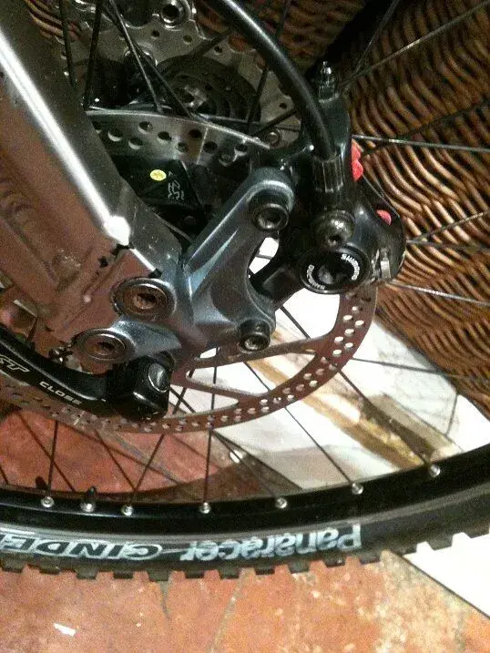

Its bloody confusion for a "new to discs" guy! I got the back one on but it was rubbing and was well over to one side...I've found a couple of thin washers and put them between the caliper and the drop out and they are now running fine! Is that a fair bodge or should I be needing spacers to bring the rotor away from the wheel a bit? Also as my last rear caliper (PM and had an adapter to fit the dropout) had lateral adjustment the old loosen squeeze brake lever and tighten bolts...the IS doesn't seem to give me that adjustment or are there rounded washers similar to those on v brake blocks?
Apologies again for my ignorance but if you don't ask...
..Cheers Wook...

Yes, thats the correct way to adjust them, using thin spacers/washers to align the caliper centrally over the disc, don't put washers behind the disc as the disc gets hot and can expand pushing it further out from the hub.
as you have figured out, IS callipers are centred about the disc using shims - you can make you own from coke tins they are 0.1 mm thick - I used them all the time or you can buy them 0.1. 0.2. 0.5 thicknesses etc.
the post mount have a slot in the calliper so are adjusted by moving the calliper then tightening the bolts - some come with conical washers that you fit between the callliper and mount/fork another set between calliper and bolt that can angle the calliper - if the form post mounts are true, it shouldn't be necessary for them; in fact formula r1 callipers fit without the conicals between fork and calliper whereas avid elixir have them.
by the way = the XTR calliper you shown you sure that is correct with the split pin? pretty sure they should have a bolt in there.

So to get this straight...is this one the wrong way round?
http://www.chainreactioncycles.com/Mode ... elID=54880
Yep, wrong way round as per description: Genuine Shimano Post mount adaptor, designed for front forks with IS mount to Post Mount
wookiee":2arsd0kg said:
Yep, you will need the 'Front Post to IS 160mm' :)
Cheers mate me and my stoopid head!
Thanks for your patience
Wook

Thanks for that makes sense really with the washers...may have to try the coke can thing...but will go for Diet Coke as trying to keep the weight down! :lol:
As for the pin...the original pin snapped so they have been replaced with what you see...the guy who sold them to me said that the current pins came with new brake pads...should I try to get the originals back in?
