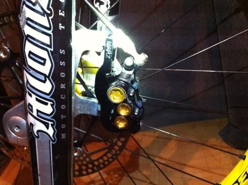

Has anyone ever tried the twin front disc set up - just curious :wink:
Enid_Puceflange":32cz9gwl said:
Oh dear :oops:
6 pots & 9" rotors :lol: :lol:
Overkill :wink:
G
WOW :shock: thats mightly impressive :lol:
Bet that catches you out the first few times :lol:
