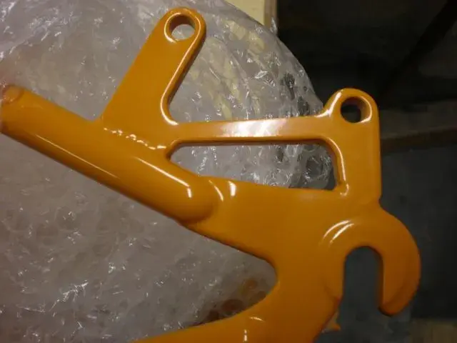

I've just done this for my son's GT, i did it the hard way, fabricated the disc tab, TIG'd it on and fresh powder coat.
It's going to be a hotrod, classic frame (tiny 14.5", well he is only 11 :D ) with a mix of new parts.

if youve got a flat plate dropout its quite easy to make a brake mount
and drill and tap it to your frame using the q/r as an additional mount point
