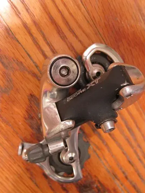

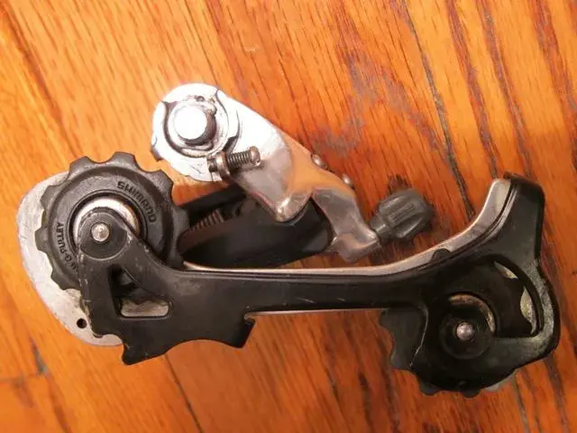

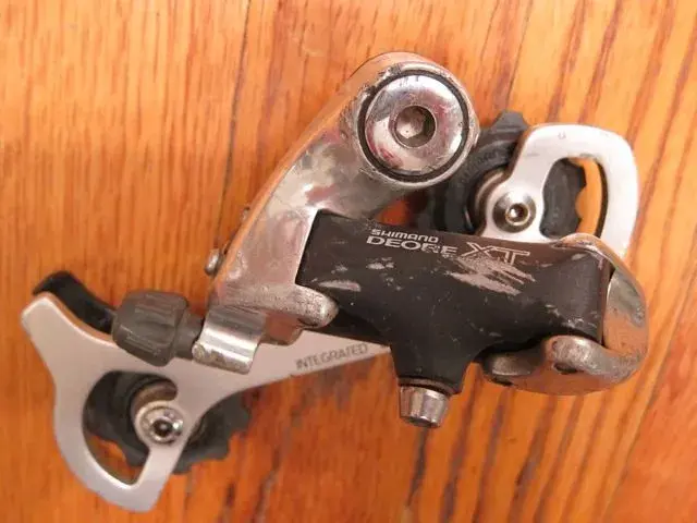

			Drewson":27je5uxq said:So I'm gonna run my M739 mech with an earlier M737 group.... Few will spot the difference unless up close and fewer still will care that it ain't M737 anyway![]()
I think those are both M739 derailleurs. "rd.jpg" is an RD-M739-GS, while the other two pictures are of an RD-M739-SGS. The RD-M737-GS also had the more sculpted, polished aluminium cage. In both series, the capacity details were printed onto the SGS cage, and stamped into the GS version.yo-Nate-y":1ajkf9ts said:The RD swing arms are different as well. I don't recall which was which, but one was a DX-like silver front and black back plate of the swingarm, and one was solid feeling metal like 730 series XT.
Here are some pics. The short cage mech is the one that seemed higher quality to me, the long cage is the one with the black/silver swingarm. Not sure which is which, as they've both been sold forward.
Sorry, yes, you're quite right.yo-Nate-y":2to0stcq said:One was definitely 737 and one 739.
