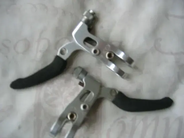

Hi, I was just wondering if anyone knows of an easy way to tell, ( by looking ) which Kooka Racha levers are which?
I've been using them with XTR cantis so I'm guessing that they are the canti version, but I want to be 100% sure before I put them up for sale.
Any help would be gratefully appreciated.

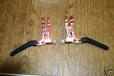

The only difference is the hole where the cable end inserts into the lever. On v-brakes it's a little further back then on cantilever brakes:
Cheers David!
On closer inspection mine are the v-brake type. Silver in colour just as in your second photo.
Thanks for the help.
