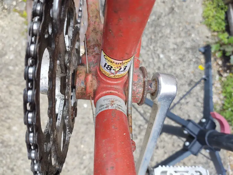

Picked this up cheaply locally. I expect it will become a donor bike as there appears to be a slight flair on one of the rear seat stays. Perhaps from an attempt to increase the tear hub space?

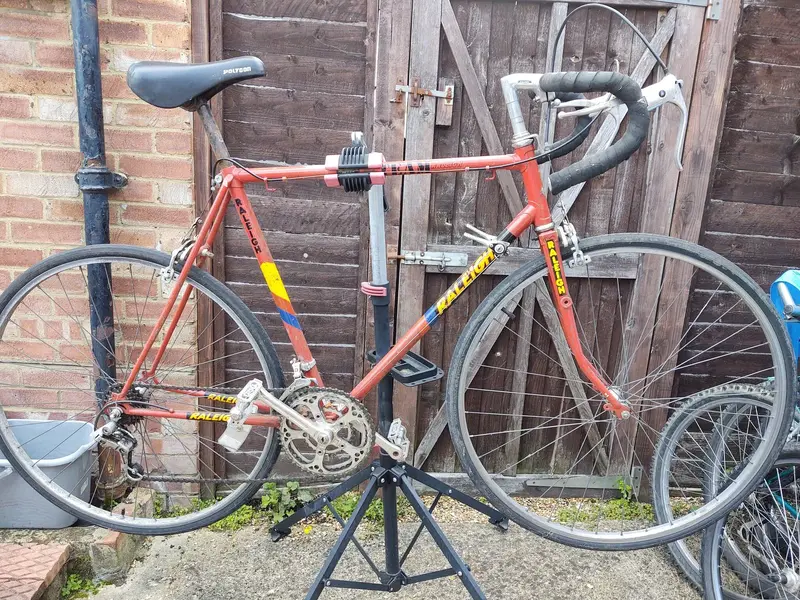

Anyhow, it was bought years ago "restored" apparently. It certainly isn't in original spec as it has Shimano deer head gears and a Stronglight triple. The paint is slightly rough as if it has been rattle canned but if it has been why replace the ordinary/original stickers in picture #2?
Anyone have any clues what it is? Raleigh gas pipe bike with team stickers added later perhaps.

Ignore the "Team" decals. Looks like a gas (18-23) pipe jobbie. Although "gas pipe" is derogatory term applied to most tubes that are not Reynolds, Columbus etc. Still a worthy road bike IMHO - but don't spend a lot on it...
I assure you I do not use the term gas pipe in a scathing way many of us will have ridden and enjoyed gas pipe bikes as kids and older, me included.
It sounds like you agree that someone has put team decals on a lower end model.
