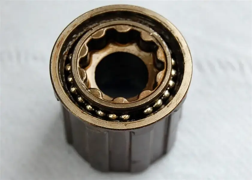

Been investigating a growling noise coming from my rear Deore LX Parallax hub - M563, generaly one per rotation.
So, removed cassette and checked cup/cone & bearings and all seemed OK, so removed freehub, and when I removed the rubber seal at the very back of the freehub to expose the bearings, I was a little surprised to see a gap approx' 1 bearing wide...
Now, I'm no bearing expert, but surely there shouldn't be a gap like this... I counted 25 bearings, anybody know how many should be in a freehub like this?
Cheers

I'm no bearing expert either but I've had a few hubs apart over the years and that doesnt look out of place to me.
In a "loose" ( ie not caged) ball race the rule of thumb is to leave one ball space vacant, which is what you've got here. Looks right to me 8)
When repacking old headsets use loose bearings and fill it up[but no huge amounts of grease].Then take one ball out
Standard practice :D
However it can help to fill it as sometimes it makes it feel smoother,try it full and remove one if you think it warranties it
Flush it out with oil - Finish Line XC or similar - before you put it back. Helps if you fill it with oil then put your mouth over then end and blow the oil through the freehub body.
