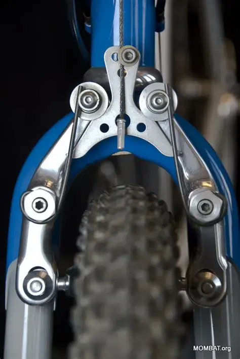

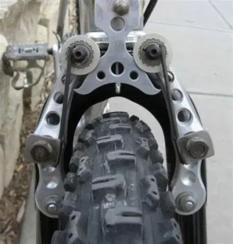

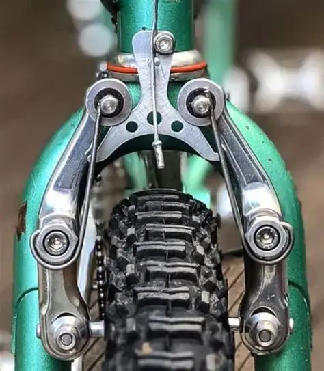

The WTB roller cam had different profiled cams, so at least offered some different lever feel. I suspect trail and error though:
My understanding is that the others, especially Campag Delta could not offer this soft tuning. Perhaps the Shimano AX?

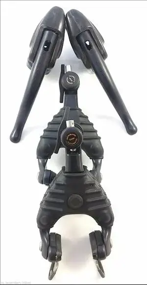

Campag deltas were used in road races by quite a lot of people but I don't remember seeing many outside of the pro peloton. Modolos were quite popular in time trialling circles for a while while the Weinmanns were rare - I think the ones I set up were the only ones I ever saw other than at trade shows. I've spent most of the evening trying to remember whose bike they were on but that information has been lost over 40 years. The semi-automatic (joke) adjusters on the Weinmann brakes certainly made the task easier, as did a lightly tensioned 3rd hand tool.

I just stumbled across a couple of models of Delta brake i was unfamiliar with on ebay... and the old favourites obvs.
View attachment 912712View attachment 912713View attachment 912714View attachment 912715
I imagine many were made in response to the beauty, cost and sculptural quality of the campagnolo delta - which came in 3 and 5- lever versions.
I also imagine they were as annoying to set up and as disappointing in performance.
I've onlyset up campag and shimano ax roller cam, anyone familiar with the others in action?
