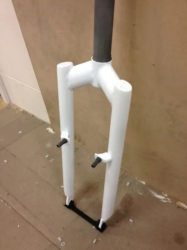

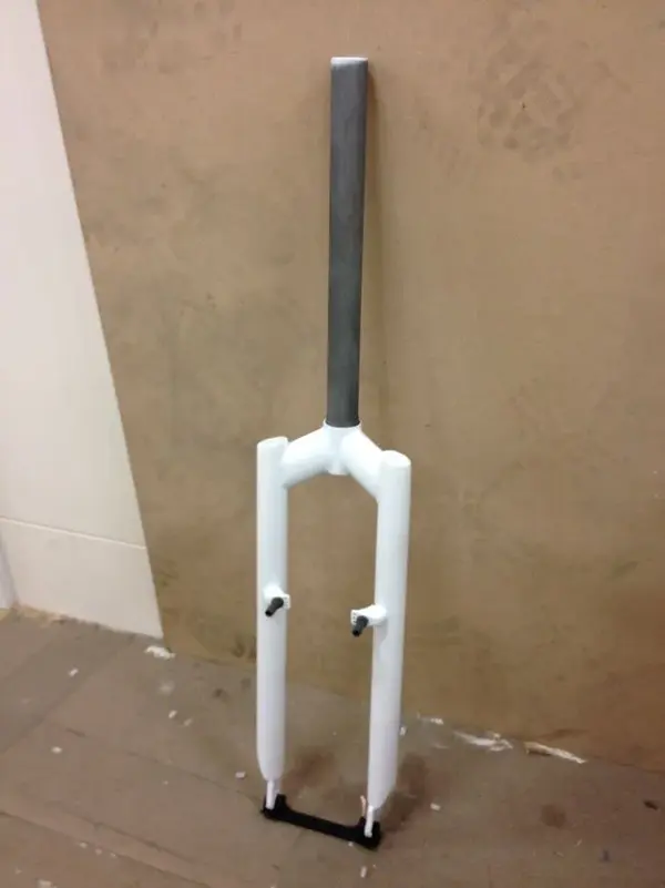

Just received the new On One forks.
Somehow I don't think I'll be worry about steerer length!!!
Not light (1.15kg after steerer is cut) but at under £60 posted I can't grumble.

I don't mean this to sound elitist or anything along those lines ..... I like On One and have a good few of their products but ....... those forks.
Firstly they are uber stiff - painfully so.
Secondly the weight but this may not be something that bothers you too much.
Salsa Cromoto forks can be had for similar money and are vastly more compliant, lighter and personally I think they will suit the classic lines of the frame better.
Just my 2 Cents
Salsa forks0g
I know what you mean about the forks. Both forks weigh a fair bit and judging by the weights I should think both are very stiff.
On One 1175g
http://www.on-one.co.uk/i/q/FOOOCR26DV/ ... rake__disc
Salsa CroMoto 1130g
http://www.wiggle.co.uk/salsa-cromoto-rigid-forks/
Looks wise, I would have to choose the On One's as these look most similar to DeKerf's Tuning fork ( http://www.dekerf.com/Details.asp?id=13 ) and they match the seat stays of the bike.
Unfortunately the answer is to wait for some Tuning forks. Even then I doubt I would buy them if the owner wants anywhere near the $650 price tag they purchased them for.
Salsa Cromotos are excellent forks. I didn't like them at first but I grew to appreciate them. Not too stiff at all, and comparable to forks twice the price!
As Nick says the Salsa forks are very good for the money.
BTW similar weights bares little resemblance to how they feel in use.
In reality I have also found that the OO forks are closer to 1400g.
My Cromoto in 440mm length is very close to the kilo mark.
Just saying .....
