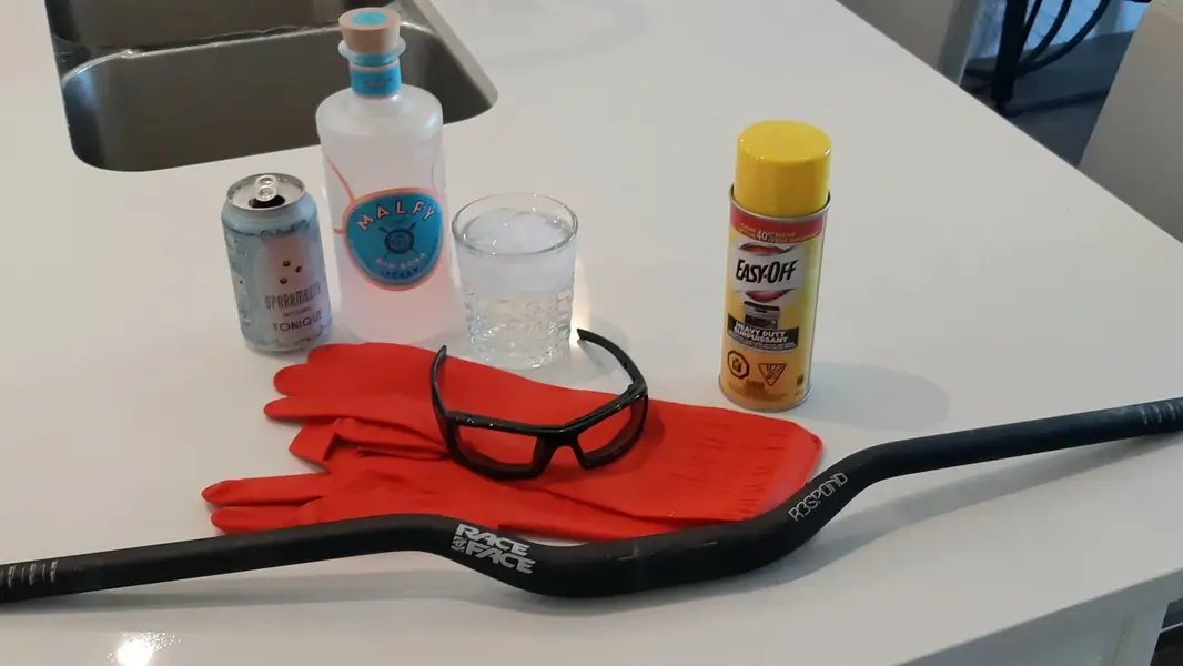

Materials: Easy Off Heavy Duty oven cleaner, scotch brite pads (course, medium, fine), Mother Mag / Aluminum polish, rags
PPE: Rubber gloves, eye goggles, gin & tonic

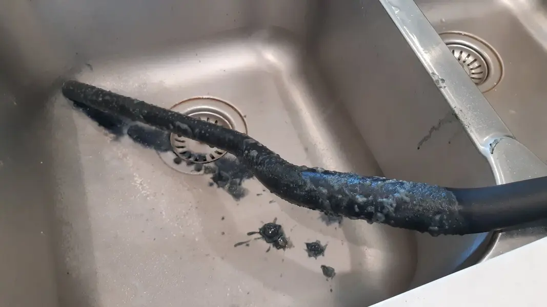

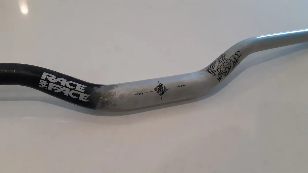

Couldn't find a vessel long enough for the bars so doing half at a time in the sink. Some pics during the process.... 15min of soaking in Easy Off, then wetting the scotch-brite pad with water and rubbing to remove excess ano

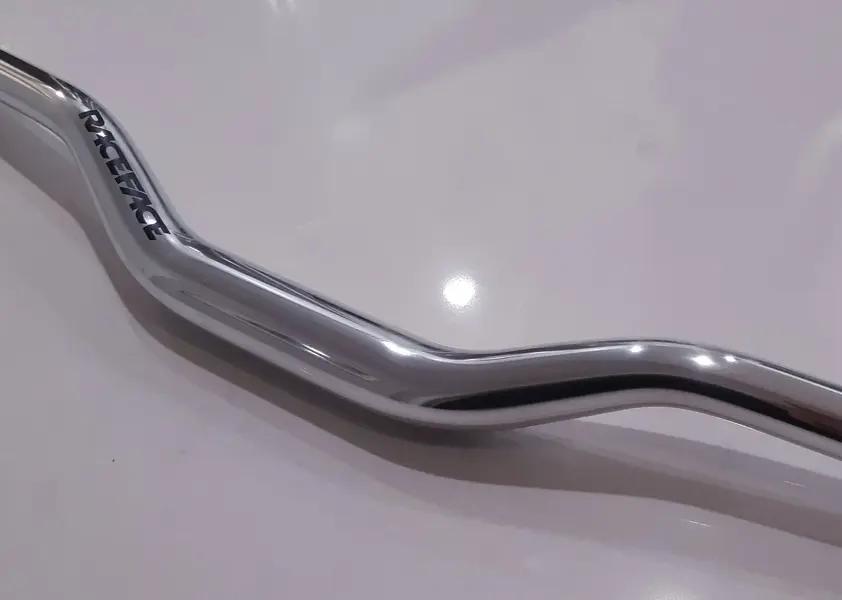

The shot peened finish wasn't doing it for me so taking it through the grits starting with 400. Then 600, 1000, 1500, 3000 and polish. Should pair nicely with the stem. Have to sacrifice the logo's on the bars but will get a Race Face decal cut
