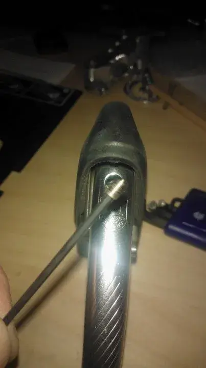

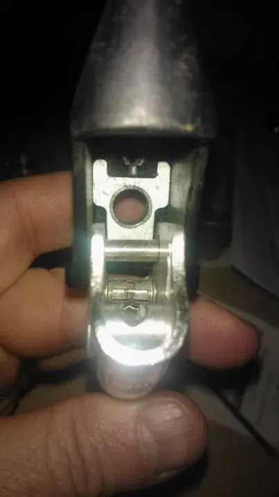

It would be really useful (to me!) if you could explain how you removed the blades from their mounts ? I managed to get the pins to move a couple of mm in/out, but I didn't have the confidence to keep hitting the punch!
There is a small grub screw that has to be removed before you punch out the pin.
Here are some picture of the said part.
