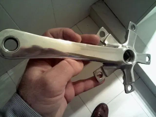

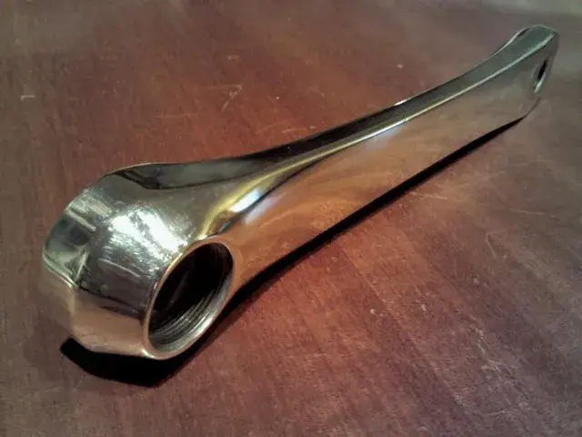

Left crank already polished after using needle file for a couple o f deep scuffs, then 400grit paper, 1'00grit and 2000grit. Then came the Dremel polishing tool and in the end hand polishing using Auto Glym Metal Polish.
Right crank is in process.

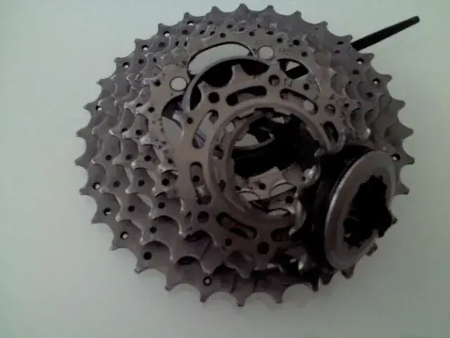

More bits arrived in the last couple of days: XTR 950 casette (12-32) and new M900 stickers.

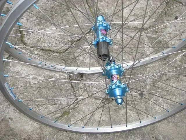

Wheels are coming from Poland (Conorio MT 910 rims and Pulstar hubs). I know the front Pulsar hub might be too bulky for this frame and forks combo but I definitely wanted some color and turquoise seemed to be quite right.

And polishing of the right crank is already finished.

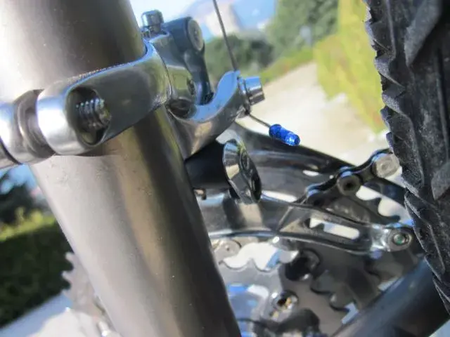

BTW, I´ve just got myself an XT M900 front mech so 953 goes out. 8)

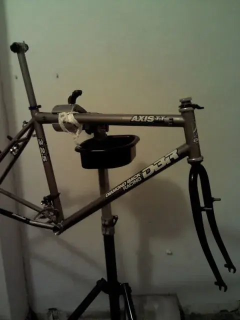

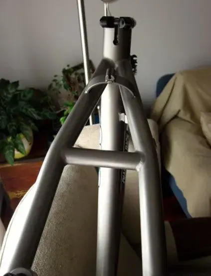

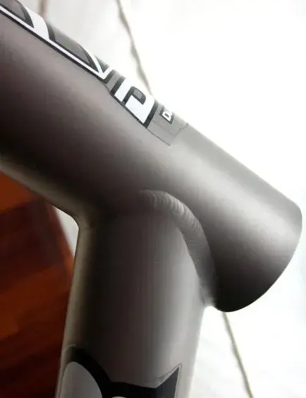

I forgot some good quality pics of the naked frame:

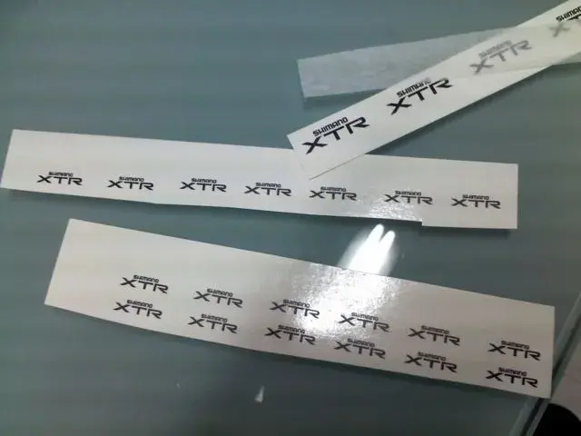

Water decals:

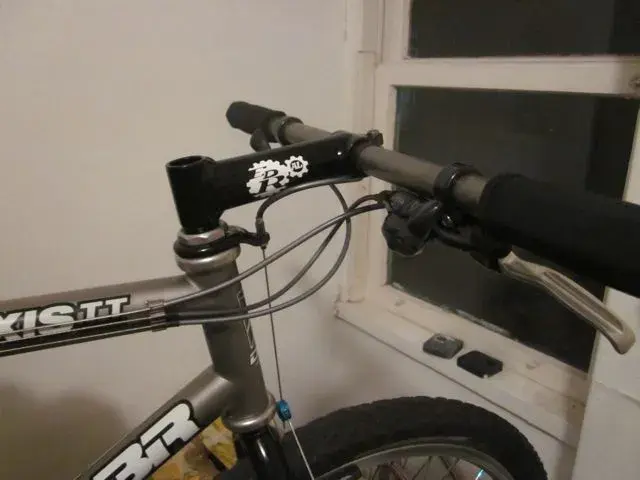

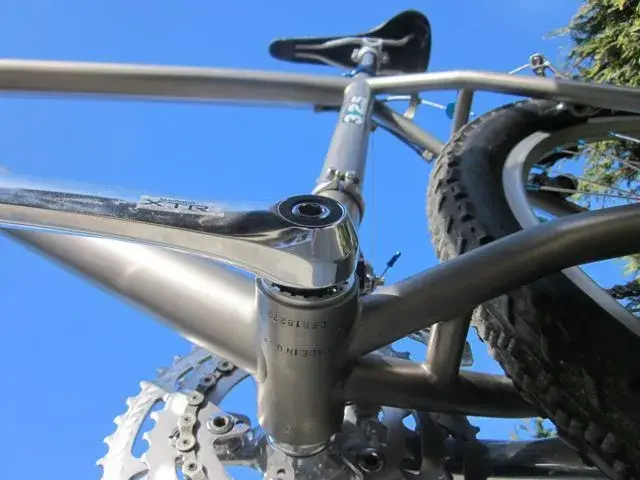

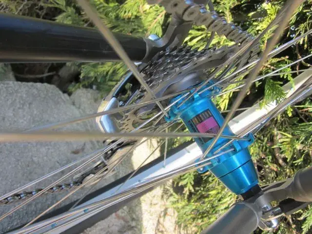

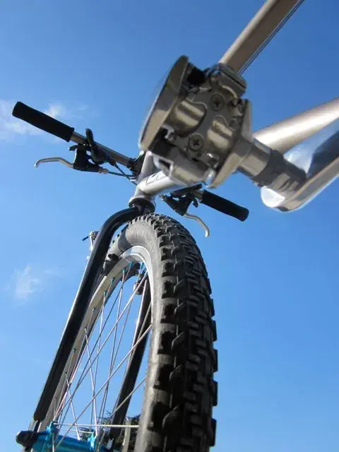

At last I got some time to work on the bike. Made some progress but saddle hasn´t arrived yet.
(Sorry for the bad quality pics...better ones as soon as the bike is finished)
Frame: Diamond Back Axis TT 1993. 3-2,5 Titanium.
Fork: Steel. Unknown brand.
Headset: Shimano XTR m900 NOS
Stem: EDR Alu. 130 mm. 0º
Handlebar: Amaro titanium. 600 mm
Grips: Ritchey WCS foam
Barends: No
Brakes: Shimano XTR M900
Brake Pads: Shimano XTR M900 NOS
Brake Cables: Shimano
Cantilever cable hangers: Onza Chill Pills NOS
Brake Levers: Shimano XTR M900
Shifters: Shimano XTR M900
Front Derailleur: Shimano XTR M900. 31,8. Top pull
Rear Derailleur: Shimano XTR M900
Derailleur Cables: Shimano
Cassette: Shimano 953 12-32 8v
Chain: Sram
Cranks: Shimano XTR M900
Crank Bolts: Shimano XTR M900
Chainrings: Shimano XTR M900
Chainring bolts: Shimano XTR M900
Bottom Bracket: LX un-54 113-68. NOS
Pedals: Shimano 747
Hub Skewers: Still searching for the right ones...
Rims: Conorio MT 910
Hubs: Pulstar
Spokes: Steel 2 mm
Tyres: Maxxis Monorail 2.1
Tubes: Vee Rubber
Saddle: Vetta TT NOS
Seatpost: Syncros 7075 T6
Seatpost Binder: Hope
Weight: 10,100
Swekers will be gone and new ones coming as soon as I find the right ones
