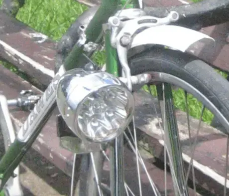

- The thinge on the right fork leg is for a light mount...

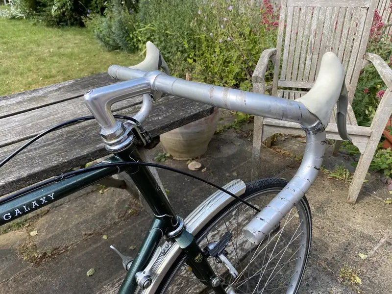

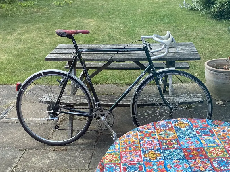

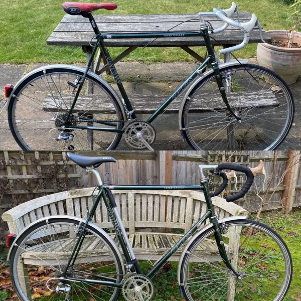

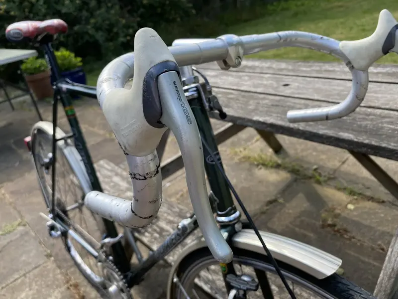

Sorry to have not checked in on this thread for a while, and thank you all so much for the very helpful replies - I read them all and some great stories and info there.
Upgrades:

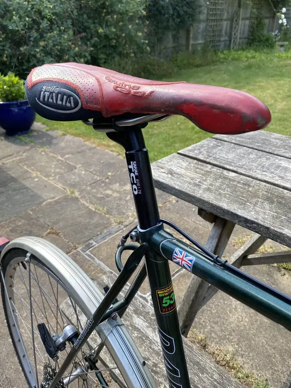

- The only decent spare saddle I had (wanted a white Turbo but already had this, so will try it for a while), a Selle Italia Flite Gel
- A very lovely NOS black "Sakae TCO Sport" seat post - 27.0mm (correct diameter) x 300mm - £14 off eBay!

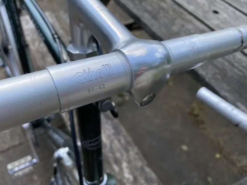

- Very good condition Cinelli Giro d'Italia bars to replace the awful ones it came with - 42cm, £16

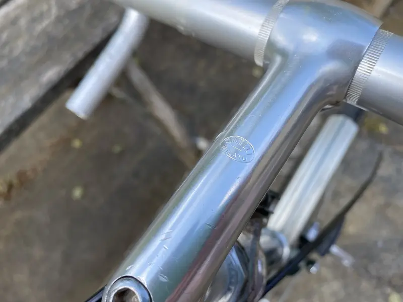

- 1970s era (apparently) Cinelli 1A stem, 105mm
- 105 levers with the original white hoods
- SwissStop Rat pads
Got the Shimano brake cables, and white Cinelli Gel Cork tape to finish it off tomorrow.
Will see how it goes and then do the matching rear wheel size and tyre upgrades later on.

Oh and the stem was £16, levers about £10 (came with 105 brakes but I didn't need them, so sold them). Brake cables super cheap from SJS. I know the 1A stem can be had for about £5, but I thought this being an older, supposedly 1970s, one was nice, to match the 1970s frame.
I would have tried to find parts that were original for that bike, but I'm weird that way, it's the old classic car thing in me.
Hey froze. For sure, in some cases (cars especially) I would agree with you. With this most likely being a 1975 frame, with the 1990s paint, I think it could have been taken either way. Reasons why I chose the latter:
- Wanted to try to use as much of what it came with as possible, and only change the parts I had to. Don't want to spend lots of money on this.
- It came with nice XT mechs that I don't have another use for, and didn't want to sell.
- I have 105 levers on other bikes and know and like them. Same with the 105 shifters.
- I am not keen on external "looping upwards" brake cables - prefer them under the tape.
- I have very large and wide feet, and my preferred pedals are the DMR V12 Mag in silver which I may use on this later - would have looked odd with the rest of the parts 1970s.
- If I change any parts later for modern bits, for ease of maintenance and replaceability, it won't look odd mixing new parts with 1990s ones.
- With the 1990s paint job, a full 1970s finishing kit was always going to look mis-matched anyway.
- If I don't need to strictly adhere to its original time period, I can use whatever spare parts I have already. Also, to me, it's a bit more fun and weird this way.
- I am still trying to keep the "classic" look with the choice of bars and stem etc (hence removing the awful "ergo" style drops), and will leave the crankset on for the moment after all of the nice comments on here.

That saddle is appalling; would you like a Rolls?
