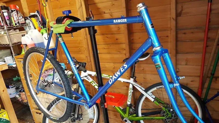

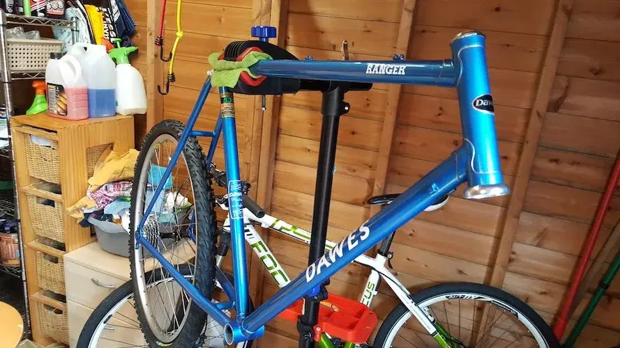

Had my Dawes Ranger resprayed with new decals in a nice shade of flam blue by Rourke Cycles. They did a cracking job, really pleased with it. Just a bit bling but not too over the top. Really looking forward to putting some kit on it now.
Will be a relatively slow build, finding the right parts as I need them.
Does anybody have much info on how this particular bike might have been equipped originally? I don't really know much about them. I only bought the frame set as I saw some builds on here from other members and really loved that retro 'long' wheelbase look.

Really nice.
It depends whether you want to be original, or practical. I'm guessing it's late 80s, so originally may have had a screw on 6 or 7 speed block and friction shifters, rather than a freehub and cassette and indexed gears.
If it were mine, I'd be tempted to fit 90s components, a 7 or 8 speed cassette, maybe even a 9, but still use thumbshifters. I'd also be temped to use V-brakes, I really like them, so much less faff to set up than cantilevers. Just as long as the components, seatpost, stem and handlebars are silver, which I reckon would look a lot better than black with that lovely blue paint.

Spooky – that's pretty much what I'm thinking myself. I want to actually ride it and get some use, so I want the components to be more a little more late 90s. Thinking of buying some Nitto Bullmoose bars and using a 7-8 speed groupset, already got a nice set of thumbshifters.
Thanks for the advice.

Very nice paint job :)
This bicycle has a very long wheel base, so I will go retro, no doubt. This is not a fast bicycle, the stering will be vague and it is not a very handy bicycle, so you will not need powerfull brakes. A eraly cantilevers will work fine or even a roller cam if you whant to do something different.
I will be close to the original except in the gears levers, I will go for a 8 speed XT mid 90´s, they work very vell:

Thanks madjh - yes, a very long wheelbase - just love the way they looked, but probably handle like a wild pig.
Thanks for the catalogue pictures too, very useful, not seen those before.
