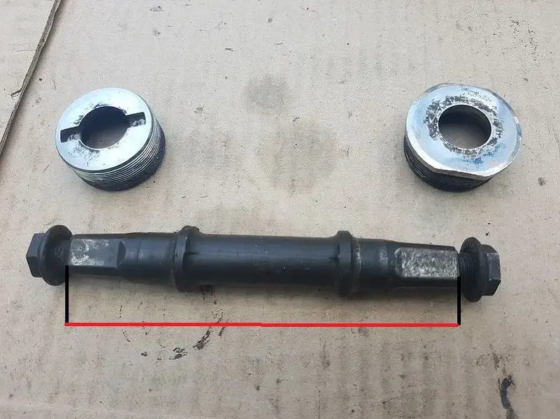

It’s about 1995 vintage. There was play in the bottom bracket before I removed it for spraying. I understand this can be replaced with a modern sealed BB. I want to keep the Super Custom chainset you can see in the picture. What measurements do I need to take and will I keep the same drive shaft? As you can see I am a bit in the dark on this one.

It will be a standard 68 width on the shell, all you need to measure is the length of the axle, the length of the red line in the picture.

Thanks for that BB has been ordered.
